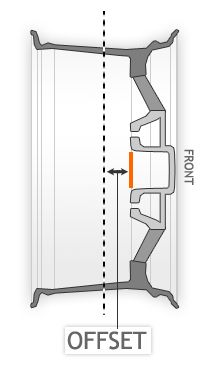

What the hell does offset mean? Haha...

Offset is how far the wheel mounting surface is 'offset' from the centerline of the wheel. So a +40mm offset means it's 40mm from the centerline toward the front of the wheel. If it was negative it would mean it was 40mm towards the back.

heres a plain and simple solution, just take a plum bob, hang it on the edge of your fender lip, with the wheel off, and the truck jacked up, measure from the hub ( the flat spot where you lugs are) to the center of the plum bob, this will give you the offset youll need for you wheels, just like any import truck youll prob. need like 5-6'' backspacing on you wheel to get them to tuck, if you have questions on how to do this just look in minitruckin a few months back, it shows how to measure your offset for you wheels.

Haha, okay... I should have known that. Deep dish rims have the - offset.
