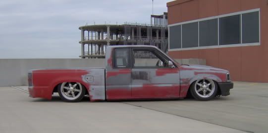

I got a standard cab 4by bed on my extended cab We just sectioned in front of the wheel wells 9 inches and created a super short bed. I ll dig up some pics of the build up
down2earthdawg's avatar
down2earthdawg
here you go
Ill dig up some more build up pics later

downtoearth...what kinda wheels are those? -bf
down2earthdawg
eagle alloy 219s ill dig up the link to their site
