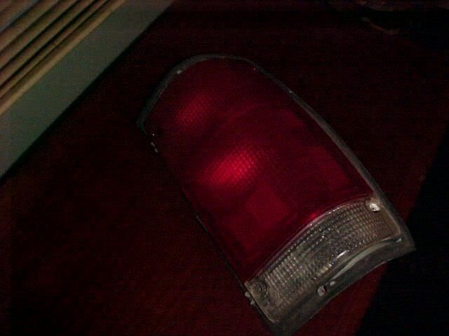

smoking taillights?

I've used Niteshades on several of my cars. Make sure to use light coats and wetsand with like 1500 grit between coats.
The neatest application of Niteshades I did was on the front corner lenses on my Contour. They're clear,with a chrome reflector inside,and I took the lens off,sprayed the chrome reflector inside,and put the lens back on. That looked pretty cool,tinted from the inside,while still having a clear lens.
