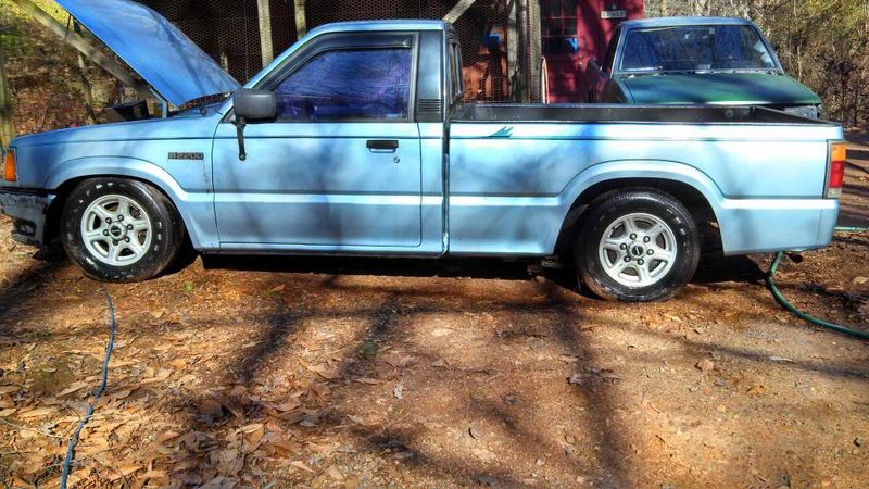

emjay
Here is a point of reference for you. This is my current daily driver when I first got it. Rear has 4" blocks and de-arched springs with overload removed. Front had torsion bars completely removed. All shocks blown (still are) and riding on the bump stops. Basically as low as it can go without notching or lowering control arms.
And a shot of the rear weighted down. Front has torsion bars reinstalled before I adjusted them to get back up in the air.

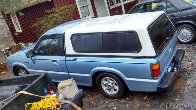

dangersoulylow
post pics so we can see what ya got and go from there
