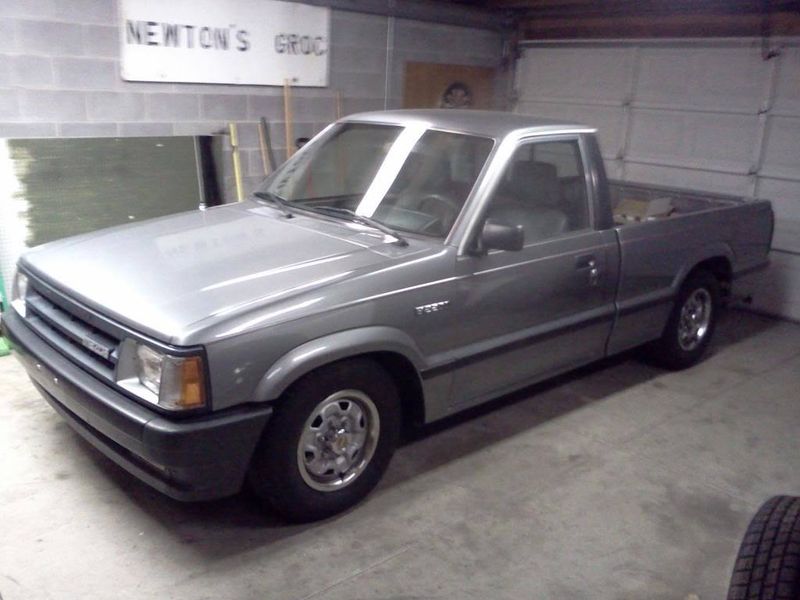

i just lowered my truck this past weekend and did lowering control arms and 3inch blocks from DJM. i also removed the 2nd leaf in the rear. it rides a lot better than stock.
hears how mine sat at stock height

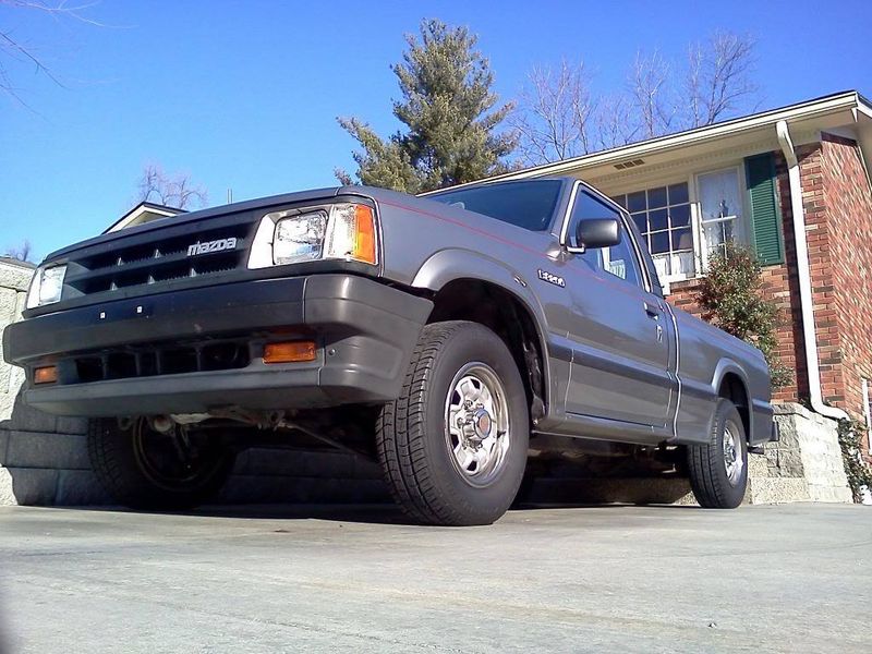

here how it is now,i love the ride

I really just followed the directions they gave me, after you reinstall your torsions it tells you to take the adjusting torsion bolt in the middle of the truck and back it up 2 full turns, I think its ether for resetting them or it gives you that extra inch. After I did that I measured out my sides and they where a touch off so I adjusted them about mabe a quarter inch where it made it even.

I'd say go with lca's,drop spindels set your wheels out about 1/2 inch, also I'm riding on stock shocks, I felt them bottom out a couple times today , i think i will be changing to Isuzu pup shocks. And yes lca's are mainly doing the lowering instead of torsions,but you get a better ride out of them and your wheels won't camber.
