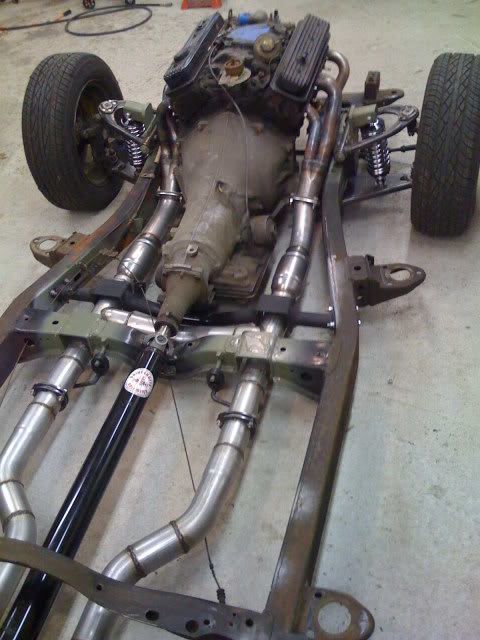

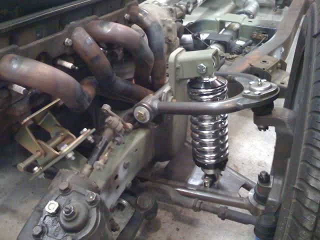

oo7bob
The QA1's are 2.5". You could take a chunk of 2.5" exhaust pipe and see if it will fit through the stock control arm.
But, the upper shock mount is weak, and a 7.5" coilover only has about 3" of travel total. That means only 1.5" of up travel, you will hit the stops constantly.
A bit of stiffening on the upper shock mount and an air shock would probably get you what you want.
I'll help a bit, the stock shock for a mazda is 9.59" compressed, and 15.2" full extend. Look through the mounting length list in this pdf. " and find a shock that is close.
I have the QA1's on my maz, but have not driven the setup.

1hotdawg
Always loved your set up Bob.
The 7.5" is compressed length...My DT's are actually a lil less than 7.5" compressed. Not sure of the uncompressed length. My ride is decent with them. Again if I were to do coilovers I'd do them WITH the torsions in tact, sot here wouldn't be too much stress ont he factory mounts...but maybe a gusset or two would be in store. I'd think an extra 150lbs of spring rate would probably do what I'd want.
I have never measured the opening in our factory control arms, but I did think along the same lines as you in getting a piece of pipe the length and width I'd need and check the travel. Will have to do that one day.
Thanks for jumping in bro.
