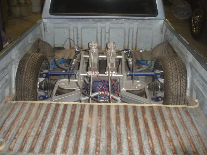

not an rx7 but heres mine... not the best pic.... its a ford supercoupe 7.5 with kustom werks control arms
shrobs187
what did you have to do to the drive shaft to get it working ?
idminitrucker (jason)'s avatar
I used a drive line out of the super coupe for the back and then used a part of the mazda drive line and then made a sleave that fit in the super coupe one and the mazda one fit in the sleave (my dad has a lathe so it was easy) i put every thing together in the truck and used a dial micromiter to tack it together and spin it to make sure it was staight. and then final welded it. It came out really good but it took me like 4 hours to do. I am planing on taking it to a driveline shop and have them make sure this one is perfect (needs some minor tweeks i think to be staight and then balanced)or to make me a new one.
