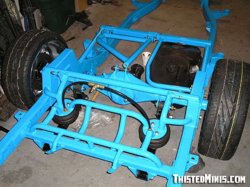

ok so i got my bed off gonna start doing the notch tomorrow now if i was to run a 4 link what are my options with the gas tank? is it possible to leave it in the same location?? can i fab up custom upper link bars that curve around the tank?
paparoach1983's avatar
paparoach1983
yes you can you could do a wishbone upper link. looks like a v but two points on the axle and one on either side of the rig. and you would need to raise the gas tank a little err at least the safe thing is to do it. at least half an inch to an inch

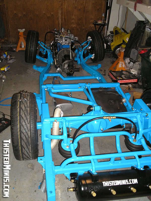

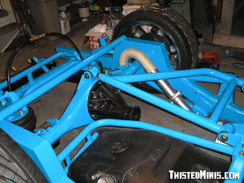

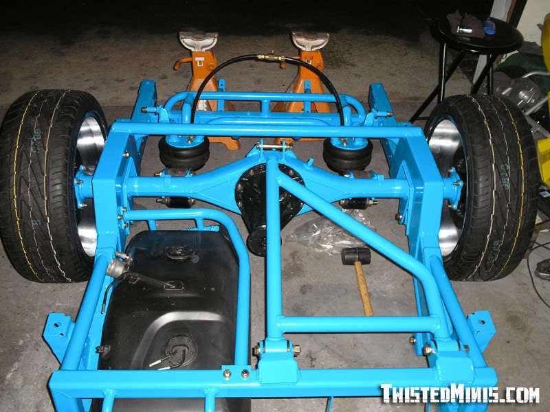

v8mazda4ever
You could also do what seth did he owns twisted minis and this was done awhile and is totally killer.
paparoach1983
dang that is pretty sick and inovative lol
