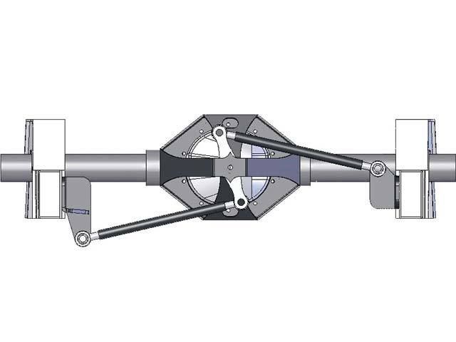

You could do a watts link too
But if your going to go through the trouble of setting that up I don't know why you wouldn't just do a 3 or 4 link.

a watts looks cool and very functional. a triangulated 4 link would be a nice way to go
