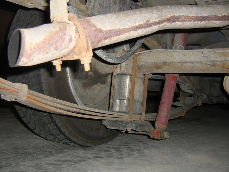

This is how NOT to lower your truck. Ever.
The sad part is that a reputable tire shop installed that entire contraption. We bought the truck like this. The bottom blocks wiggled all over the place causing the rear end to sway on the highway. It was scary.

HeY.. is that setup a 3inch block and the 2inch just laying in there... what about welding both offf them together and are the blocks aluminum???

read the line above the pic, i'll put it in bold
don't stack blocks. don't weld blocks together. 'nuff said.
