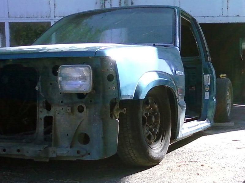

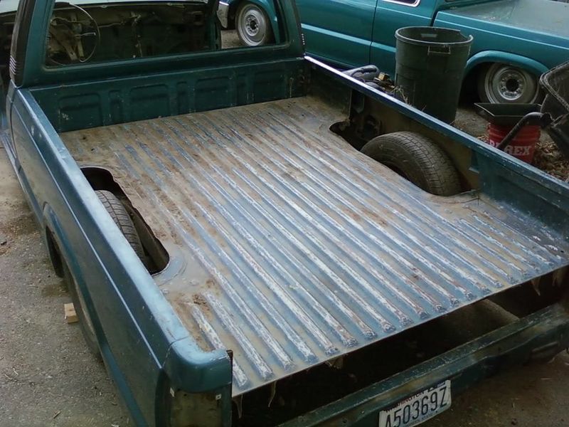

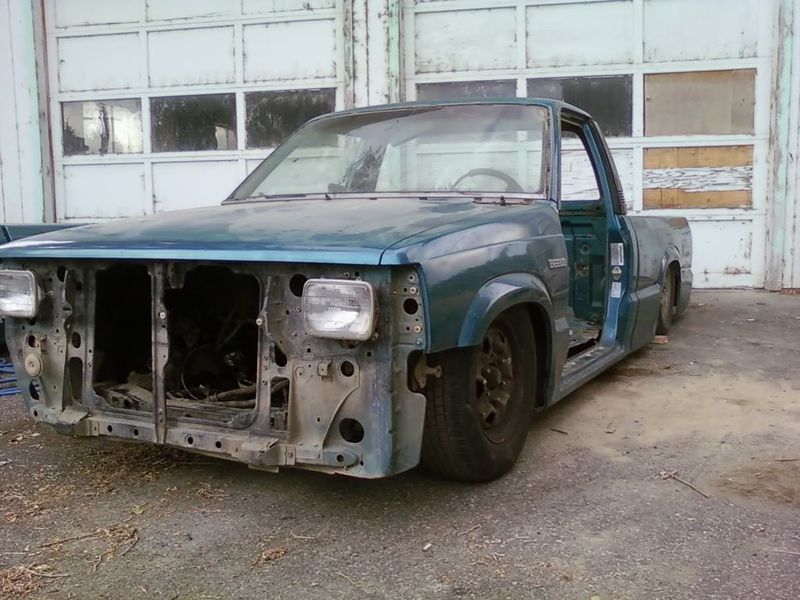

here is a pic of mine static dropped
i have a 2 3/4 body drop also
at this height i had full susp travel till it hit the groundwhich wasnt much LOL
but i had it mono leafed w 3" blocks and a 5 1/2 inch z +the body drop
the front was just reindexed torsions and all the brackets gone from the front i think i clearanced my lower control arms also
