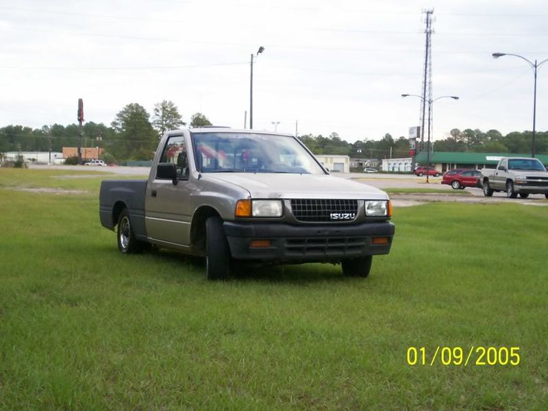

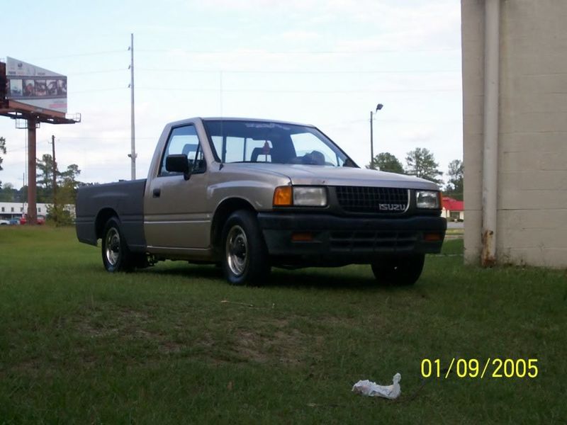

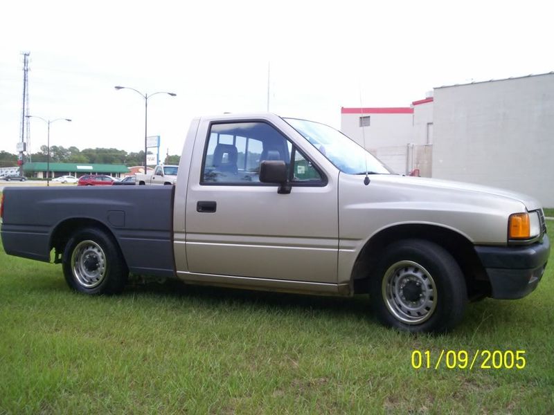

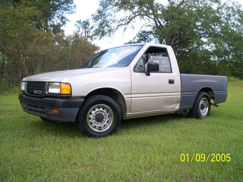

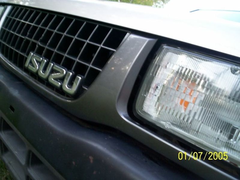

sorry for the pic quality but here are some pics:
