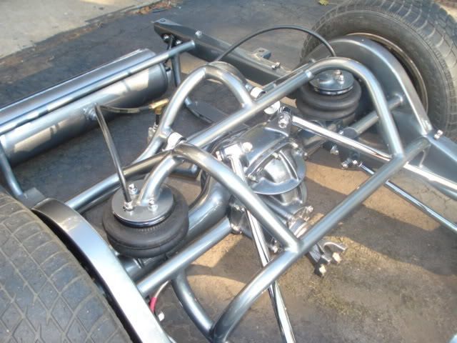

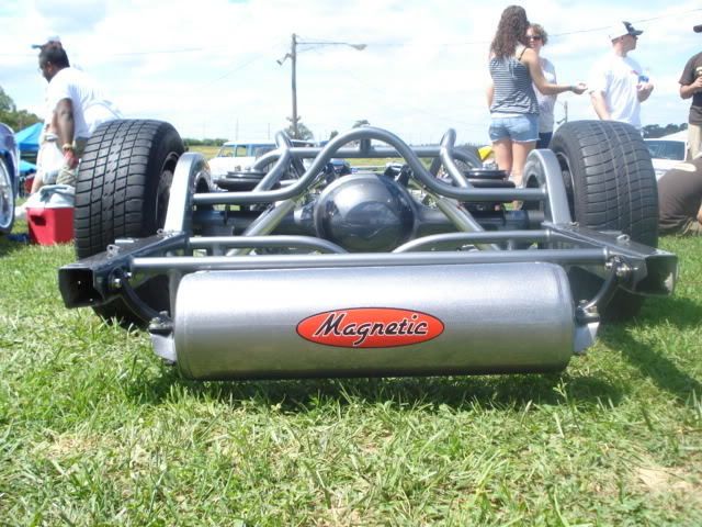

The only reason why i went to 52" in the rear is so I could run an 18x8.5 or 18x8 wheel, with 4 inch backspacing (because according to intro thats the biggest lip I can get for that width wheel).

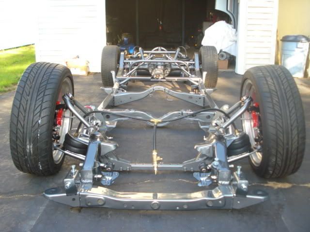

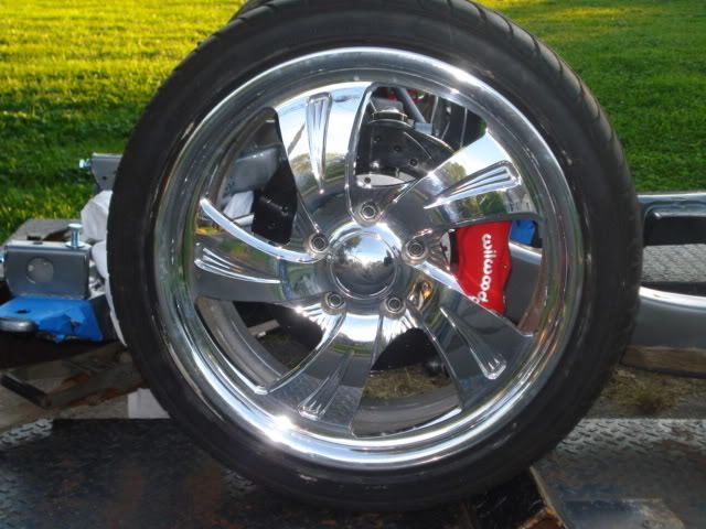

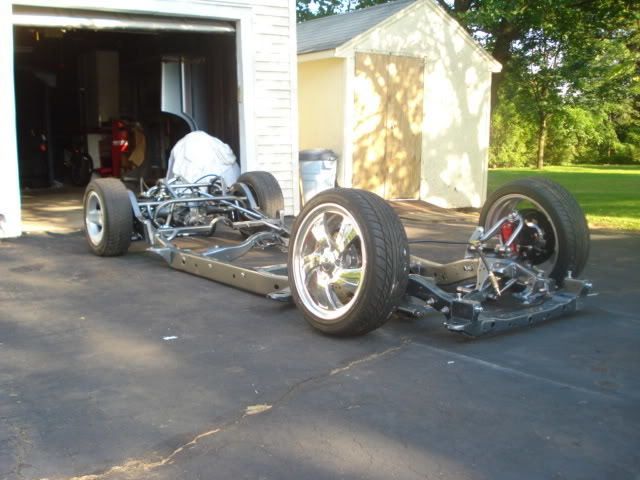

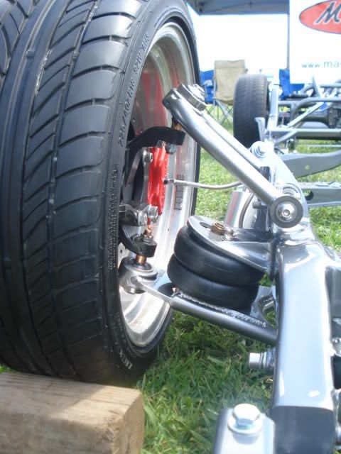

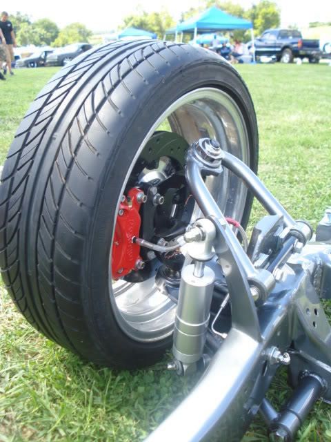

But hey check these pics out, I took my chassis to the Low Rollers show and borrowed a freinds wheels that had like almost no lip (these were 18x7), and i measured from outside of the wheel to outside of the wheel and i came up with 54 inches. So that means I should be able to run atleast 3" of lippage up front I would think, and also I am getting a new cab so I might just take it to the pinch, and have my bodyguy build a pinch on the bed so it matches.
But anyways, let me know if you think the 3" lip up front makes sense:

3'' of lip and they'll be touching pretty good on the fenders... so maybe a little less but seems to make sense to me. don't forget about camber changes too...

yes the rear is not narrowed, but It does have clearence. I have set it up so There is about 1" between the rear tire and chassis (the tire/wheel tread width will be 9.1" on a 225/35/18 tire), and it also clears the bed. This i double checked a few hundred times lol, because I knew it was very critical.

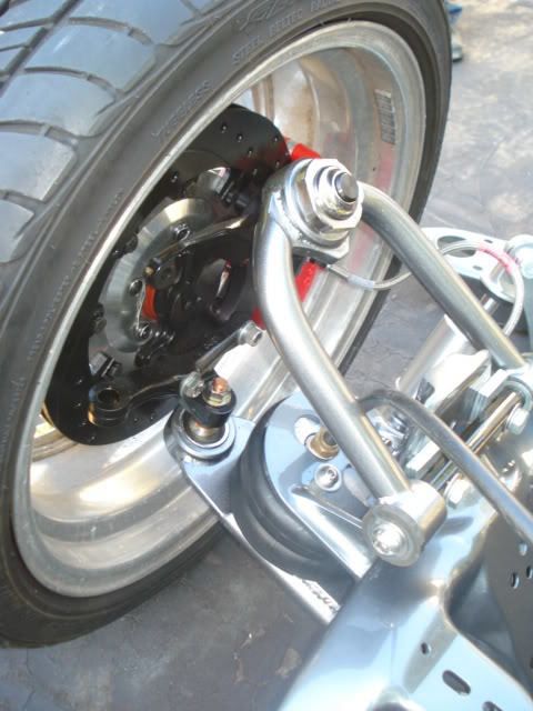

Well I figured 3 inch lip in the front this is including the negative camber. The pics above have very little negative camber when layed out, and some positive camber when fully lifted. I will need to shim the upper control arms inwards (I have spacers made for this) to correct this issue.

Well, if the outside of my wheel to the outside of the opposite wheels (on the frame right now, ones that have like a 7" backspace on a 7" wide wheel pretty much), is 54" with negative camber and tires, then the track width, I would assume has to be like 52. This gets me to believe that I should be able to fit a 18x8 with a 4" backspae in the front too. Man i should have measured all my shit before I did it so I would know.
