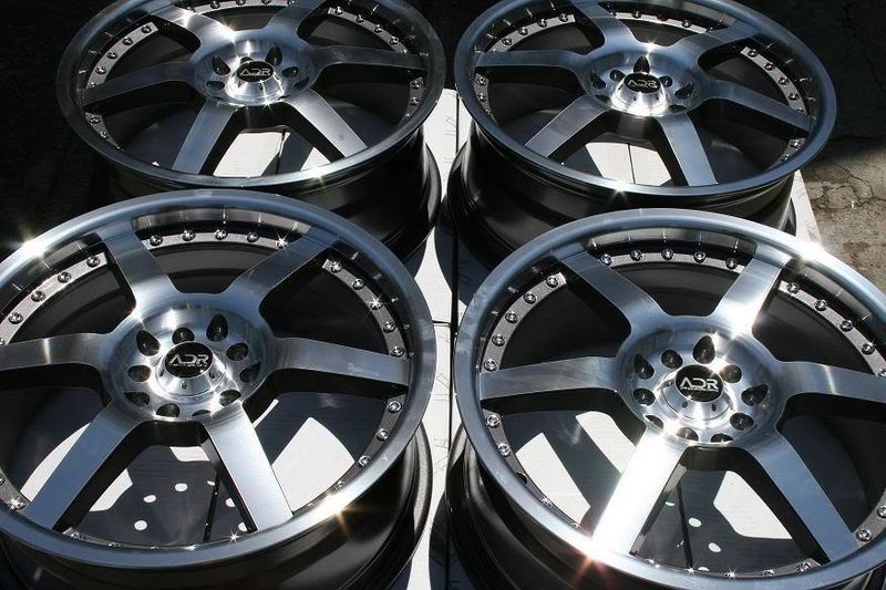

will these tuck???

coo but doesnt say they gunna fit
+48 offset wouldnt that rub the frame??

those 18" ADR VICTORY RIMS will work right and i can just buy the tuner lug nuts???
i really don't wanna buy these and then have to end up reselling them.
Bolt Pattern: 5x100/5x114.3
Offset: +48

Spacers may work. I knowsome ppl hate them but I had a buddy put them on his ranger back in the day and never had any issues.
