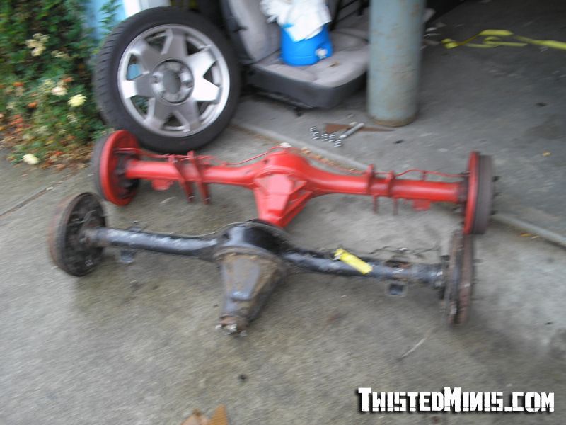

i went out tonight and bolted a wheel up to the rearend... my wheel is exactly at the edge of the fender... i have like 3.5" on the inside of clearance. i am figuring if i can find a 6lug axle that will swap in that is at least 3"-3.5" narrower (1.5"-1.75" shorter on each side i will tuck easily.......without having to build a backhalf. anyone got any suggestions as to which rearends i should go looking for either tomorrow or next weekend?????

pre-86 mazda axle. Its like 4 inches narrower.

is that 4" on each side or 4" overall (2" each side)??

Like 4" overall. I dont know the exact difference in widths.

for the rear to tuck... i need about 1.5"-1.75" on each side... i have 4x4 bed and the tires is at the outer edge of the bed....i'll send pics tomorrow

talke to twistedminis. he put a pre 86 rear end in one and knows the exact measurements and what needs to be done.

Here he says the pre-86 axles are about 4.5" narrower.
