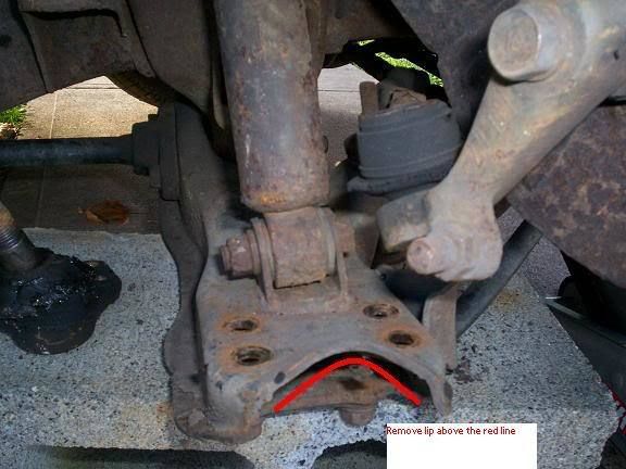

went ok for the most part, i did the brakes while i was in there,
oh and my lower control arms did not have the relief cutout so i had to grind out my own, it had a turtle shell over the lower ball joint, but all in all i am very happy...
(still want to go lower though)
dropped90(justin)'s avatar
dropped90(justin)
yeh all the arms have the turtle shell that has to be cut out. glad it went well. and i think someone had some of the drop arms for sale a few days ago.
-justin
mr.bbs
right, it just appeared that this one had a factory relief cutout, but now i realize it was just a funny angle...
