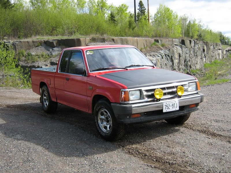

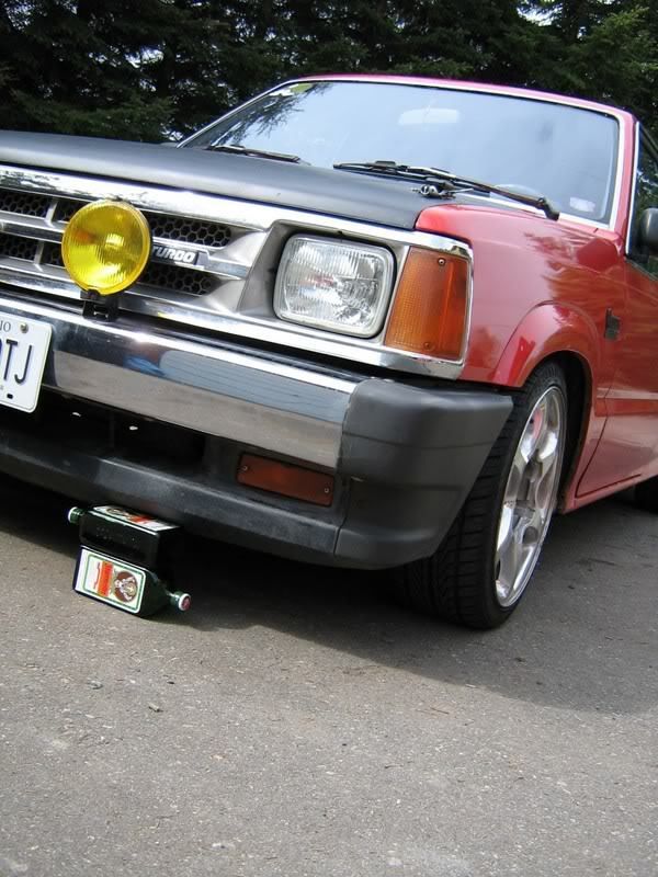

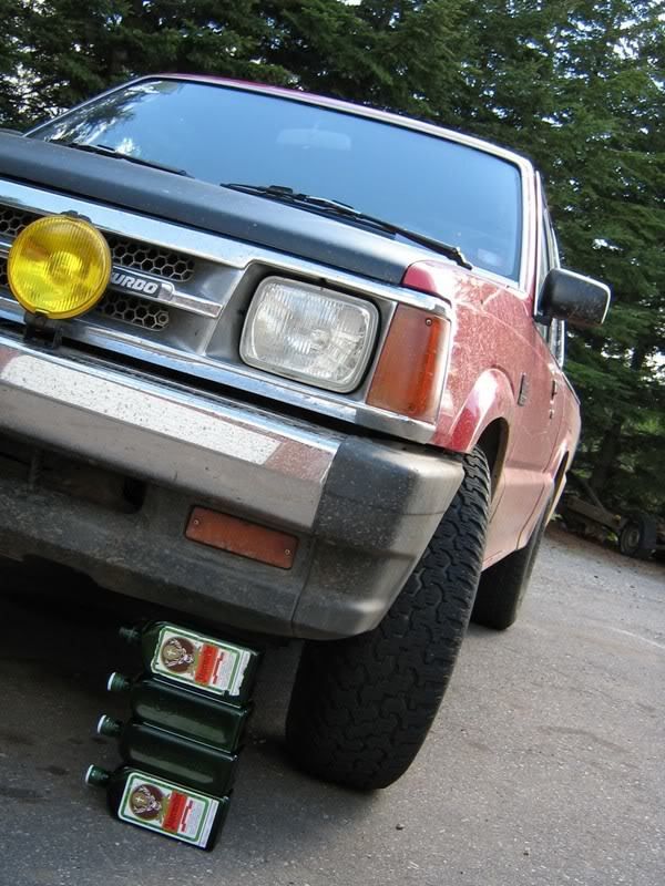

Pepehn, what did you do to lift yours and what size tires are you running now?
pepehn
Well, as you can see in the pictures..drank a whole lot of Jagermeister and.. ..... .. haha.
But in all seriousness, The back is stock, and the front..the torsions are almost maxed out (counted the number of half turns i made..but just cant remember right now..its wrritten down somewhere. lol. There is still the width of my index finger my bars can go up still..so maybe like 10 half turns or so.
I run a 235 75 15 which works out to be close to a 29" tire (28.8 i think) I took my truck out in the mud a bit just to see if anything would rub or anything, and the back is totally cool, but the front..the tires are a bit too big..they rub the inner fenders, and fender lip but not bad.
Tommorow im thinking i might to roll my front fenders, and put my bars up as far as theyll go..or maybe just a bit higher.. we'll see.
