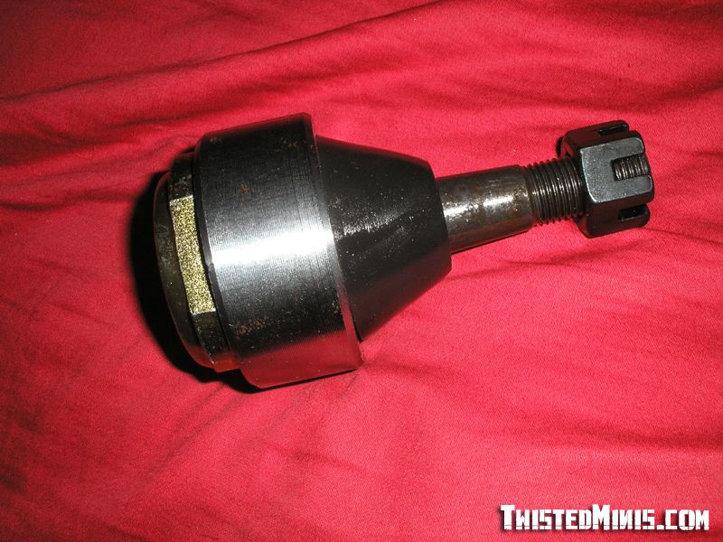

I would just order them from Speedway motors when you order the sleeves. If you just order the sleeves, you are under their minimum order amount, and they charge you an extra $10. It doesny say it anywhere but thats what happened to me.
Also the balljoints they carry are nicer than the ones you can get locally. The boots they come with are nicer (not as stiff, will seal better) and they come with a zinc plated cap, rather than a cheapo flat black coating. They're also cheaper.
I just got another set of everything to do another set of arms for a friends truck, and I am impressed with the ones Speedway sells. I think they are made by Howe, but boxed as Speedway parts (just like they do with Wilwood stuff, that they sell cheaper than the actually Wilwood stuff, lol). The ones the auto stores have are Moog. I measured the travel these got when I got them and they actually get an extra degree over the Moogs joints in each direction. I will be replacing my balljoints with these when I get my truck back. So I would get the joints from Speedway at the same time if thats the route you choose to go.
Heres the ones I just got.
I know theres something else I wanted to post, but I'm too drunk to remember what I was thinking about 2 minutes ago. Its likely lost forever, and hopefully everythign up there makes sense.
