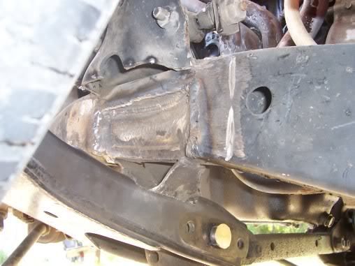

most people use RE-6s in the front based solely on space.
most people that i know of that put RE-7s (or equivalent) in the front had to notch their frame out to make room.
this is from a project thread in the Photo Post section. he starts baggin the front on page 6.
hambandit
do the frame work to make the 7" bag fit you wont regret it ever

Sudkrap I had air lift 2b6's in the front of my last mazda with a 350 chevy in it and it lifted sweet. now I am going to be running the re-6's and that still gives me plenty of lift. I don't know maybe I'll try it my self but all I am saying is that re-6's will lift your truck with no problem. Just my 2 cents.

Cool.. if the re6's are lifting no prob. then cool.. i could to the frame work, but i'd rather not cut into the front frame.. thanks for the help..

either bag will max out the front end its ride quality youre after. the 7" bag will ride at a lower psi and therefore ride softer. having owned the same truck with both bags on the front end, its my personal preference to run the largest bag possible. besides, theres always the awe factor of telling people you stuffed a 7" bag in the front of a mini. people will be like why? and then take em for a ride an theyre like oh...right.
its not even a comparison, really.
cliffnotes: either will work.

I checked out robbie's thread.. and saw how he did it, it doesnt look to tough.. now im leaning back that that idea haha I CANT MAKE UP MY MIND! lol, im in no huge rush, i still need to get some control arms, and my motor in etc....
