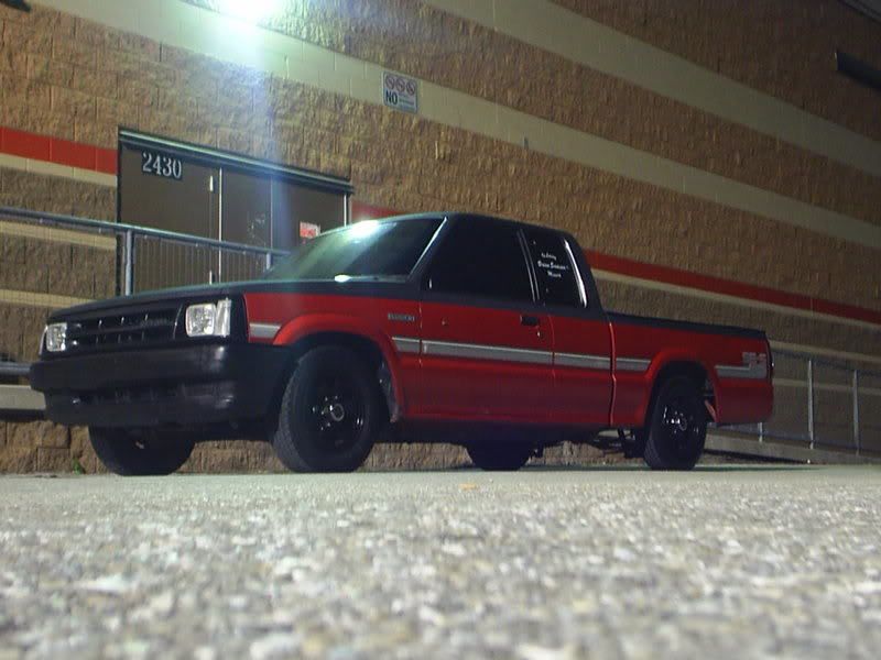

heres an idea i have 3" blocks,cranked torsions and flipped balljoints.
V
v8mazda4ever
Well if you want to go lower take your leafs to a spring shop and get them to de-arch them do not pull leafs out and run your truck it's unsafe. You can snap them easly with a hard stop or with wieght in the back.I know I was trying to spin the tires and the leaf twisted and snapped what a mess.
