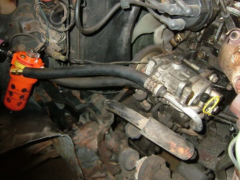

use a sanden off of a bseries truck, you can bolt it right up and it will fill a 5 gallon tank quicker than a york.
all you need to convert it is a couple peices. an inline oiler to keep the comp. oiled, filter to keep water out of the system, and a check valve to keep the air from leaking back out. i'm going to do a tech write up on this when i put one on my 86 in a few weeks.

It is a bolt in install? I'd be curious to see that. And you say its faster? Yorks are pretty fast, i'd be curious to compair the cfm of both. I guess the only advantage to the york is no need for a inline oiler.
trashed's avatar
trashed
the factory a/c compressor on our trucks is a sanden.... this is my old truck..
i ended up selling the truck before the suspension was finished but you get the idea...
