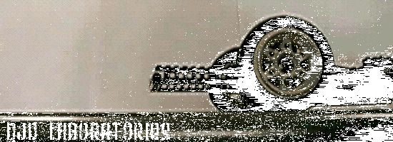

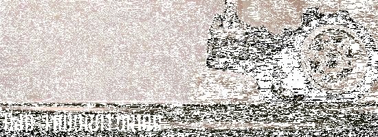

These are kind of an exaggeration as youll never get your truck to stop this fast, but you can see the what happens to the axle with a reverse 4 link compared to a forward 4 link.
reverse
forward
gravity5's avatar
gravity5
OMG finally a way for people to understand the actual situation with the reverse 4 link, and to get away from the my friend has one and it works fine routine. Thank you E69
