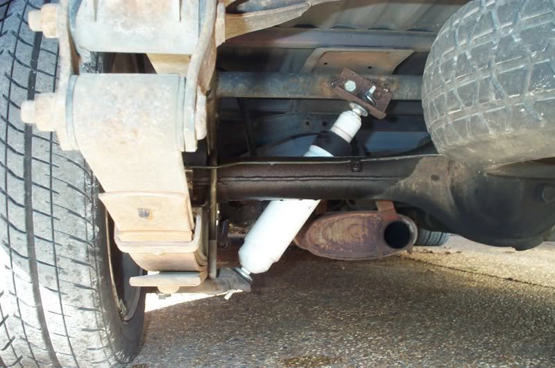

yeah that is how i am rollin, with 14 inch tires. she sits low. that is a sweet idea with the 83 mounts, i want to see some pics.
madzatruck's avatar
madzatruck
Here are some pics of the drop blocks with the 83 bracket. I also cut the U-bolts down so they didn't hang so low
