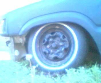

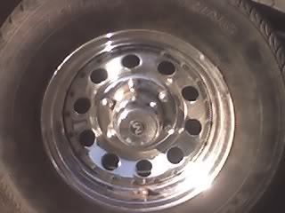

the back end isn't a priority to me right now... thats later... i need to get the front low... btw, hotdawg, i have the same wheels as you, almost...
14x8 i think... i know they won't tuck, so i am bouncing to stock mazda rims with chrome rings, chrome lugnuts, and the stock chrome caps...
