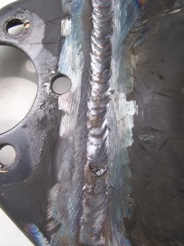

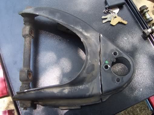

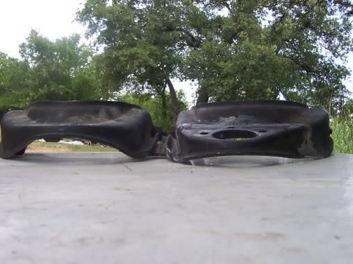

no ive got a set of drop spindles but there on my ext.cab. i just wanted to flip the balljoint 180 just like the drop spindles do. but either way it doesnt matter. im just gonna reindex my upper balljoints because there maxing out before it lays all the way out. oh and as far as what balljoints are used on the drop spindles, i dont have a clue, ive been asking the same question for a month and nobody will answer that one.
robbie
this will fix alot of your upper balljoint problems.
