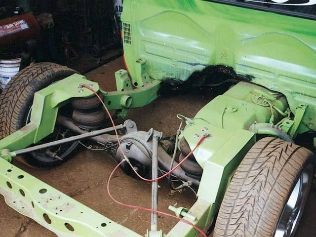

found this and love this look. this is what im goin for, im doin the back first so what all am i needin for this back only. cheap as i can go. i need a full list so i can price it. thanks -bf
slammed83mazda's avatar
slammed83mazda
thats a 50/50 link, bags over bars,
gimme a pm dude on what you want and ill give u a quote
