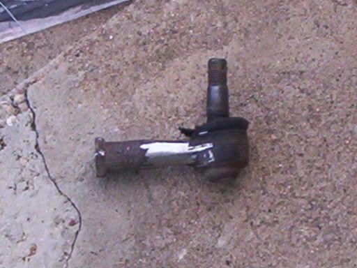

hybrid
ok this is what i did for the tie rods,since i had the yota tie rods also i cut the threaded part of the mazda tie rod and cut the ball joint side of the yota tie rod and welded them together.came out awsome i am just trying to find the other yota tie rod

looks good man i did the same swap and i payed hell trying to get those wheels straight i shortened the shit out of mine and flipped the tie rod but its a little too close to the wheel for my liking so i think im gonna go with what u did
hybrid
yeah i had to adjust mine in all the way to get the wheels lined up,still havent gotten to drive it yet

yeah i think im gonna shorten the inner tie rod end a little
hybrid
well i put 40 miles on it today and it ran great minus the bad alignment.my wheels are toed in too much so i will extendend the tie rods a few turns in the morning.
