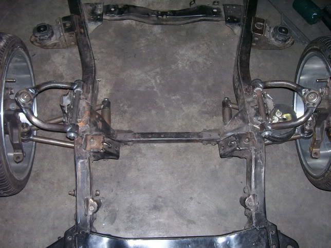

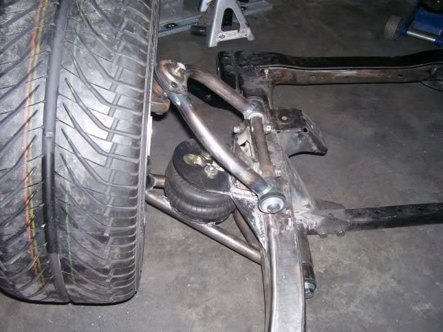

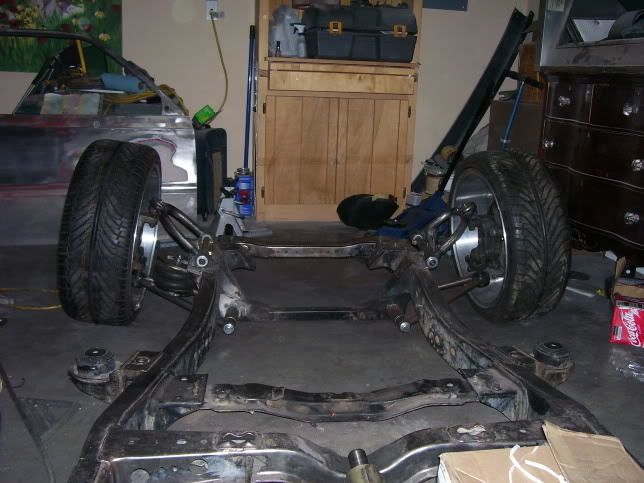

so any body got pics of the front bag mounts welded in??
low87dawg
the front is prettymuch done these are from a couple days ago will post better ones tomar
madbagger's avatar
madbagger
nice! who made the control arms?
low87dawg
kustom werks
