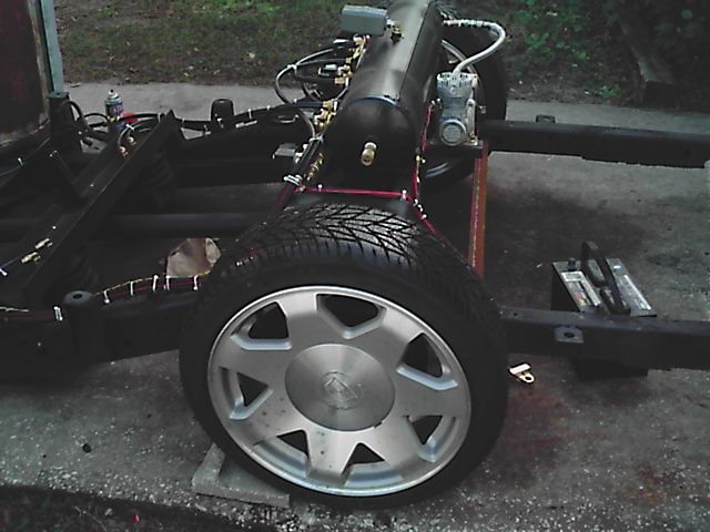

hey i'm running 47" 2-link bars.... the pivot point for the bars is 2 inches behind the front bed mounts ..i turned trailer hangers sideways on the frame to secure the bars...the bags are mounted 10 inches back from the pivot point ...layed out, the back of my frame at the tip is 8 inches off the ground...fully lifted in the rear, the tip is 39 inches off the ground...so whatever that translates into actual lift is why i like my 2 link no one around here has that much..at least not on a daily driver...and it dosnt sway the only thing i dont like is theres no side to side...but..i can dogleg it pretty high...but i hope a 2 link works out for you...i would have a four link but i like lift...rides good..just invest in some good shocks b/c with my setup i dont run as much psi at ride height and it will be bumpy without really good shocks oh and btw im running 2x3x1/4 tube bars..lmk what you guys think
boostedbusa14
this is the best pic i have right now lmk what ya'll think
shapinoweno
Nice pic man, I'm felling those rims so much.

thats beautuiful boosted...i love it....and just for a little more info ,thats what this thread is for right...my bars are28 inches and stock mazda rearends are 25 inches from the leaf pearches center to center,but i set my axle at 26 to keep from cramming my driveshaft into my tranny,and its best,i think if you weld a bar inbetween the link bars so as to keep everything sturdy...have fun!!!
