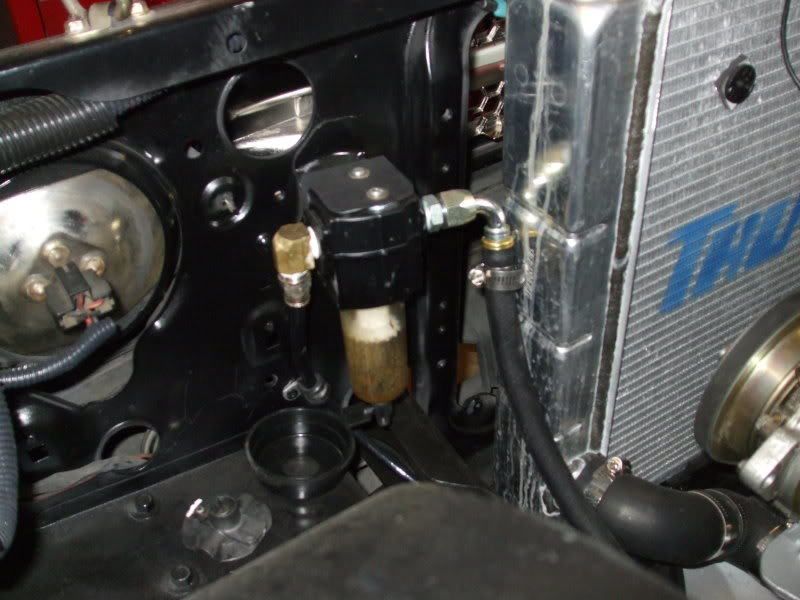

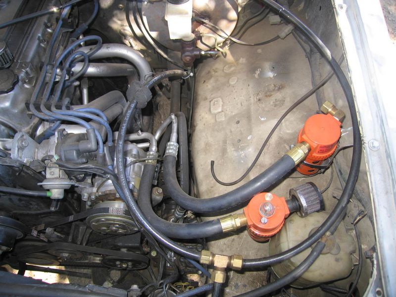

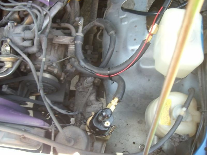

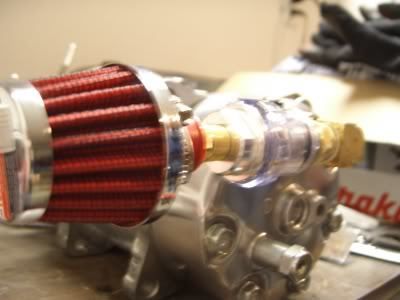

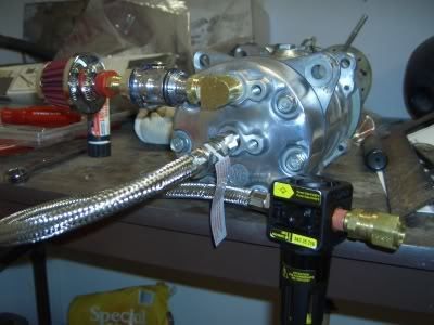

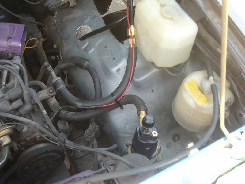

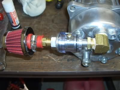

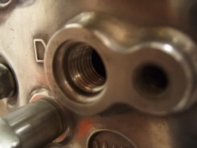

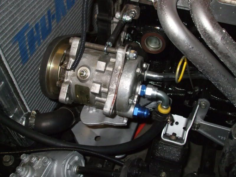

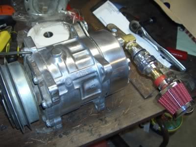

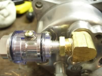

I took the rear cap of the compressor and had it tapped at the machine shop.
1/4" pipe thread on the discharge, 3/8" pipe thread on the suck side.
I ordered an Viair leader hose and an ASCO water seperator from Ricky at whynotfab.com and hooked them up to the discharge side.
The fittings I got from the local Parker store and used it to hook the in-line oiler i got from sears and the filter from autozone.
I also ordered an ASCO pressure switch from Ricky. You hook it up like any othe 12v compressor.
hope this helps, I don't have it in the truck yet, but i hope I should this week.Email me with any questons you might have.
mazdizzle
Those are some very helpful pics. I was just wondering today how I was going to hook up my sanden 708. I was going to run compression fittings on the lines comming from teh compressor but they seem to be an odd size and I was having a hard time some that would fit. My inline oiler is bigger it looks like your filter so I'll have to do mine alittle different. Is there any reason you didn't tap it yourself?
kaoss's avatar
kaoss
i didn't tap it myself because I didn't want to screw it up. my tap set is really old(like more than 30 years).Plus it was only $20 versus a new sanden 708 at the junk yard for $80 if i screwed up.
