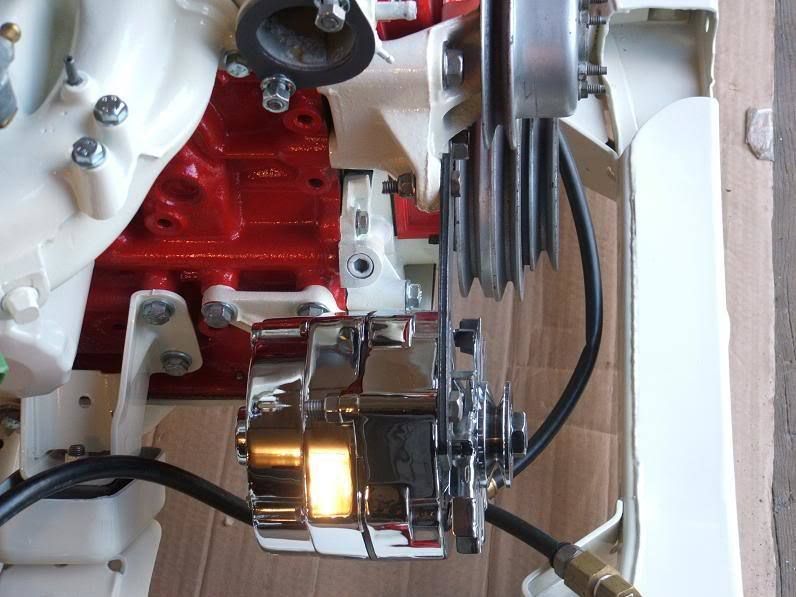

you dont need to fab brackets bro, just grind the factory one a little bit and the gm fits... vuala

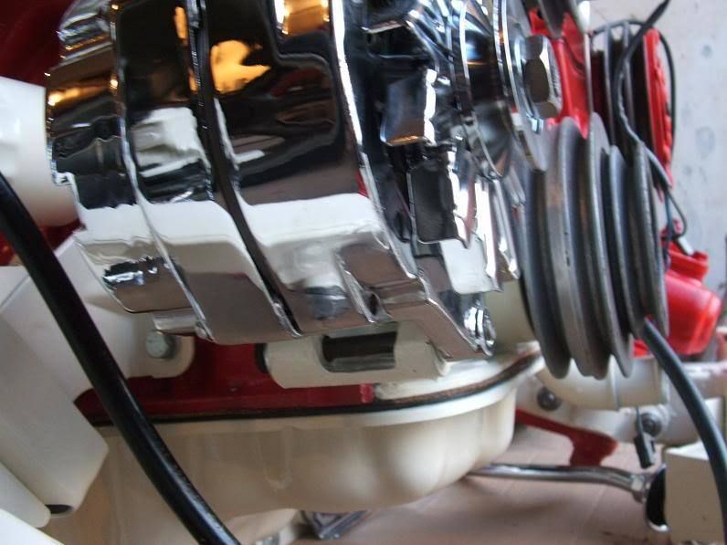

theres the part number, and i think its working lol its still starting just fine, no sign of a weakening battery haha

i bought my alternator off ebay for 65$, Chrome GM one wire, 105 amps. To install it i just flipped it upside down and it bolted right up no problem, no grinding or anything.

only reason i had to grind is because i used the stock belt, i didnt feel like tearing it all apart for a belt so i grinded my bracket lol.
