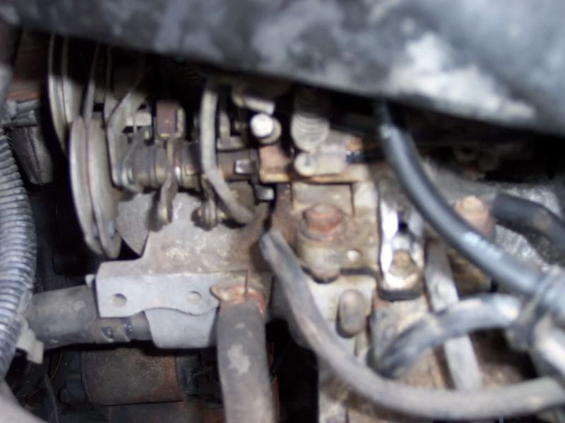

To add to mazdatweaker's pic.
1. Remove the carburetor and, using a small punch, drive the anti-tamper spring pin out from the bottom. Re-install the carburetor with a new base gasket
2. Install the air cleaner and verify that the idle compensator is closed. Verify that all vacuum hoses are correctly routed.
3. Adjust the idle mixture screw until the air/fuel solenoid duty cycle (dwell) is varying in the preferred range, between 27° to 45°.
4. After adjustment is completed, tap the anti-tamper spring pin back into place.

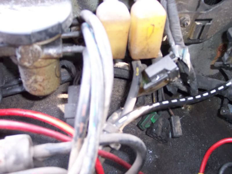

this is what i got the carb looks like its been messed with a little.
what do you think i cant find the single wire plug
8
89b2200
Well, looks like the mixture screw has been violated. LOL.
