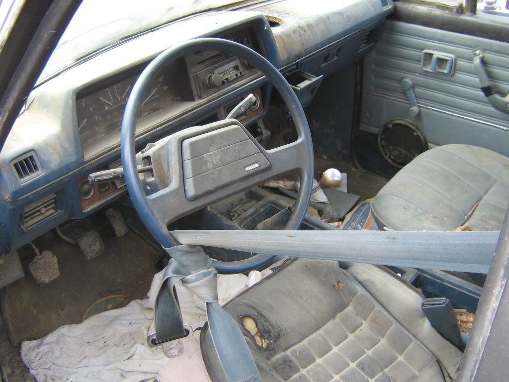

Put the rear wheels up on the dolly and lock the steering with the wheels straight and wrap your seatbelt around the steering wheel like so:
Towing it with the rear wheels on the ground with the tranny in neutral will not cause any harm either.

I say drive/push the front tires on the two wheel dolly...throw her in neutral...call it a day. I have towed trucks this way for 100+miles..you aren't going to be doing 120mph so you should be ok.
Mikey---nice use of a seat belt.thumbs up!

lol at the seatbelt. ok i think that makes things easier. anyone know if i need a battery in it to put it in neutral?
