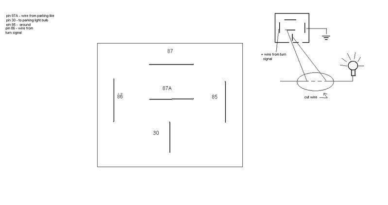

so the lights will work like a 1st gen s10?
when the lights are off, the corner and the bumper flash at the same time, but when the lights are on the corner works as a parking light and then blinks oppisite to the bumper light, so if you want the i would go and look at a wiring diagram for an s10

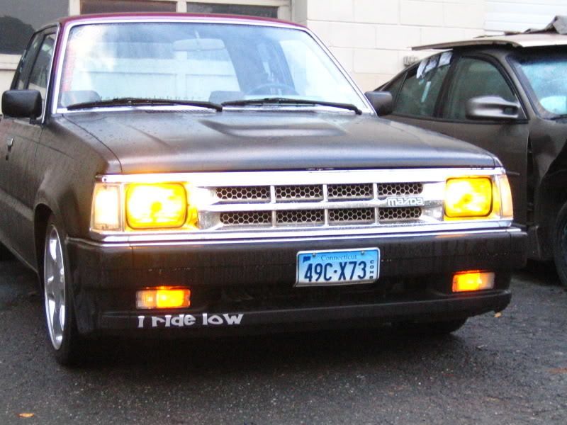

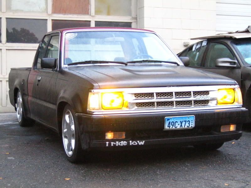

so i didnt give up! and now they work
sleepyspeed's avatar
sleepyspeed
cool which way did you wire it up? still have corner lights or?
konzern1's avatar
konzern1
yeah still have the corner lights, like i said someday ill eliminate the corners and make them just blinkers, or maybe not, my h4 headlights have a pebble crack so i guess im gonna go with some ranger headlights......gonna trash the HIDs

here's what i was tring to show you earlier..
