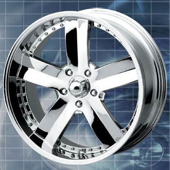

Oh bummer! Well if you put in your vehicle descrip at the top. It weill then show you Your wheel and tire specifications and what offset and backspacing as well as lug pattern, etc! It then filters out everything that is not a direct bolt-on and shows you what fits with the desired size rim or tire you want!
If you can see this, this is the rim I think I may have my sights set on:

that wheel is sharp, but it is 5 lug, best thing to do would be go by a rim shop, and see if they have some wheels & tires that you could try on for a good fit before you spend all that money on something that might possibly not.

There picture is not accurate in terms of lug amount. There list does show that they have these in 20 and 18's for 6 lug pattern that will directly fit my truck without rubbing, etc.
