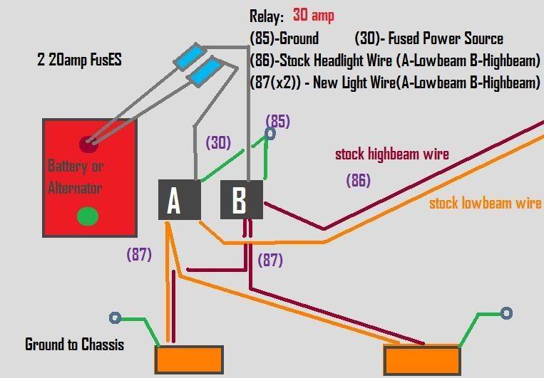

While your at it, Your wiring probably isn't the best for being in your truck 16 years..So if your looking for a little more light, you should upgrade your wiring. You can give them direct battery power (14.3 volts compared to what they might be at now)
If you've ever wired foglights with a Generic 5 prong relay, Its similar to that, what you would usually use as a switch will be your old wiring, hook up battery and ground, then use the 2 outputs for each headlight (Low/High, you need 2 relays) You should use all 12 guage wire.
I've heard you'll have up to 30% more light output by wiring these like this, Depending on how your wiring is. Test the voltage and see how much your getting first.
