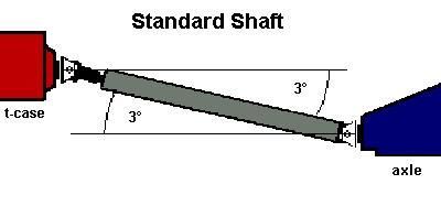

A 2 piece shaft with carrier bearing of course changes this a little bit. Typically when you drop something with a 2 piece shaft you correct the angle by installing a carrier bearing spacer and a transmission mount spacer, along with correct shimming of the rear axle in its saddles.
The problem occurs because the driveline gets straightened out when you lower. Gotta restore the angle. When the driveline is straight, u-joints don't work correctly; they're not pivoting on their axis. Extreme wear happens pretty quickly...
