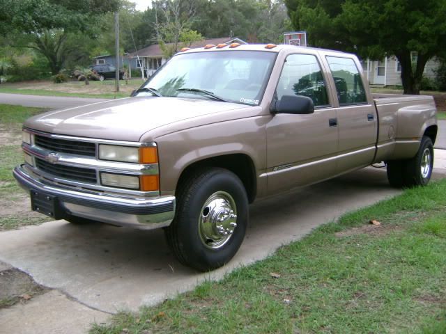

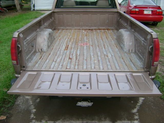

Well I sold my body dropped dually and a week later picked this one up.
It's a diesel and its a tall mofo.

Plans, not sure. Probably leave it tall. wish I could find a way to lift the front to match the rear. Paint and hopefully some semis sometime.
