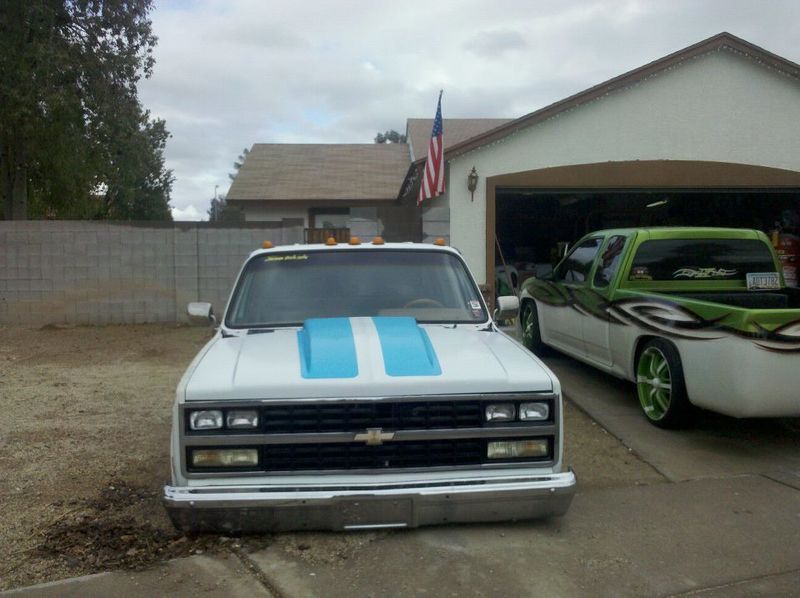

went out and took a few pics today..
the served in the southwest show along with our toydrive is this coming weekend. need to prep the hood for welding closed the goofy vent holes, and white primer the hood and rear fenders to match the truck.. might put some simple graphics on the hood, not sure, we'll see...

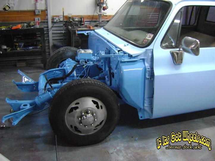

Did figure it would but had to ask. Love the truck, the hood turned out KILLER!!!!!!!!! Do have a few questions about your front suspension. What all did you do up besides the Z'd frame? Spindles? Drop arms? I kinda figured out your running air bags, kinda self explainitory, but what else have you done? You had also stated earlier about your bridge going to house your fifthwheel/goose neck hitch. Any pictures of that setup or possible hooked to the trailer?
LOVE THE TRUCK, keep up the GREAT work!!!!!!!!!!!!!!!!!!!!!!
bk2life
stock spindles, stock control arms. UCA's are pie cut, LCA's have 8" tube mounted in them for lower bag mount. frame where coil spring would sit is modified to allow LCA to come up way higher than where its supposed to. upper bag mount is welded into the upper portion of the frame. think of it this way, where the upper bolt-on bag plates bolt to the spring cup, mine is cut about 2 inches higher then where those plates would bolt in with the four bolts.
this allows the LCA to articulate and come up way higher thus not needing spindles.
when i get the semi wheels on, i will have to rebuild the control arms to mate up with the 3/4 ton hubs.
