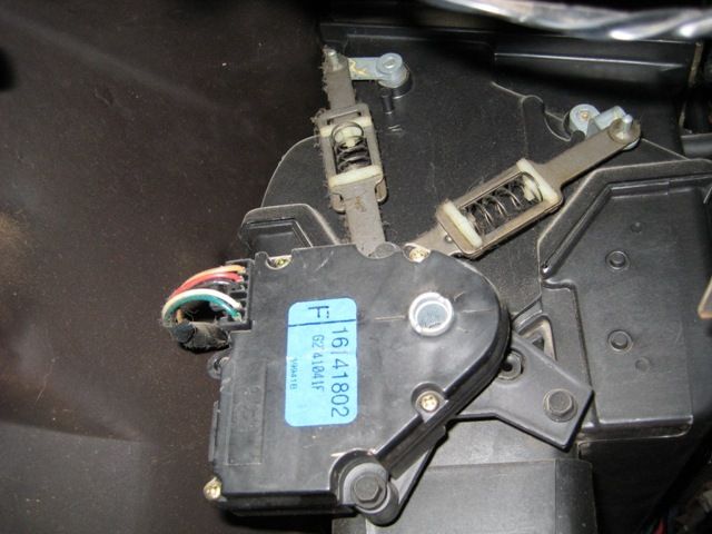

OK, once you replace the A/C control...back to the vent position, most likely cause is gummed up linkages on the actuator. This is the one at the far left of the A/C box, just above the driver's side of the transmission hump:
Lay some newspaper down on your carpet to protect it, wash down the linkages with WD40, work them back and forth a little. You'll see that the flat metal parts are actually sliders. The factory lube gunks up and they quit working right. After that WD40 dissipates a bit, a small amount of white lithium grease might be a good addition.

YA it sucked. Im lucky as I work at a dodge dealership and my friend hooked me up at employee cost. Thank you for the pic Richard I will mess with it tonight and let you knw!

quick update: I checked that actuator and it was working fine, but still cleaned it and lubed it. I kept looking around and decided to pull blower motor to check evap, it was pretty clean maybe even changed a few year ago . But I noticed the fresh air door was open half way, ran some test and it didnt move no matter what setting. So I adjusted it to be in reserc at all times now ac is much colder! But also found blower motor wires are getting super hot

Did the airflow problem between floor/dash get corrected? The actuator working is one part of the picture, the sliders being able to work is the other. If it began working properly without you having to do anything, then the A/C control that got stolen was probably bad.
On to the fresh air/recirc door actuator - it goes bad way more often than the other two. It's kind of a PITA to replace but can be done in about an hour with just a few simple tools. I posted a writeup on ChevyTalk and FullsizeChevy that I could repost here if you want.
