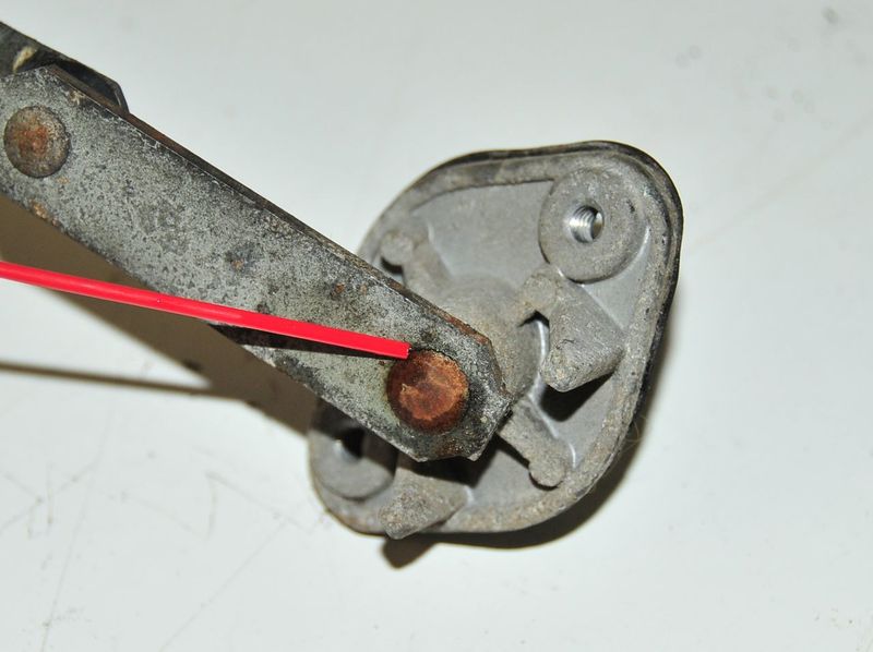

Also, check to see if you have any slop between the two wiper blades. If so, then you probably have a worn out bushing between the two - very common problem. It also doesn't hurt to pull everything out and lube things up.

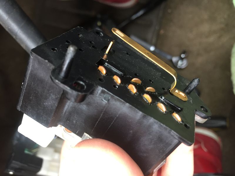

and i looked through your link and the picture with the two switches, the one that i have is the one with the clear plastic on the back

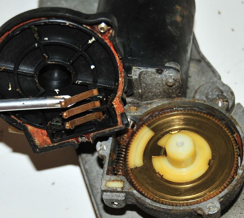

Sounds a little like the motor is weak…. OR, you might have a weak connections in the wiper switch or the contacts in the motor itself. So I would definitely clean it up as shown in the thread. Not positive, but I think you can pull the wiper switch off of the combination switch housing without removing it; just needs a short philips screwdriver. However, if that switch is dirty, you can bet the other switches are dirty. So I would be inclined to pull the whole combo switch housing and remove and clean all of the individual switch. ABE has a good thread on it here:

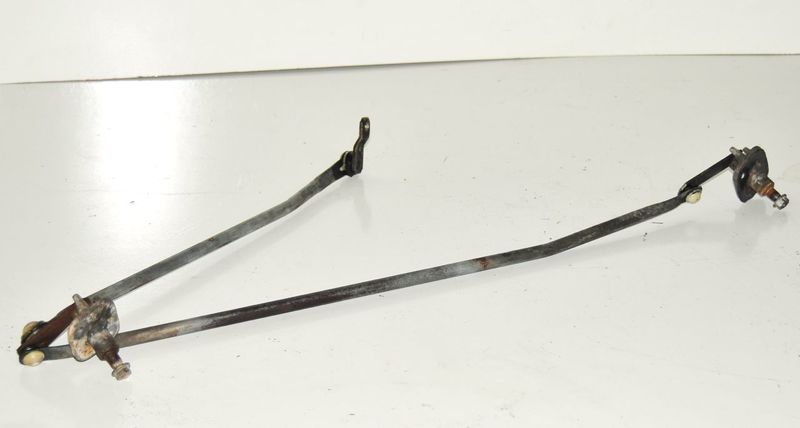

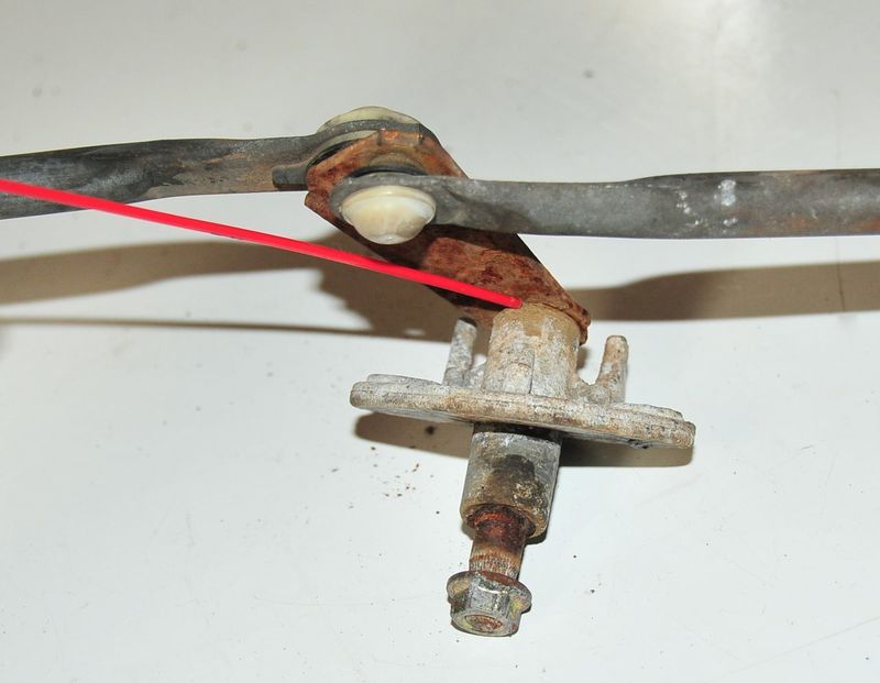

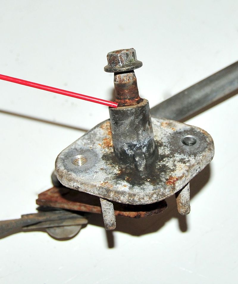

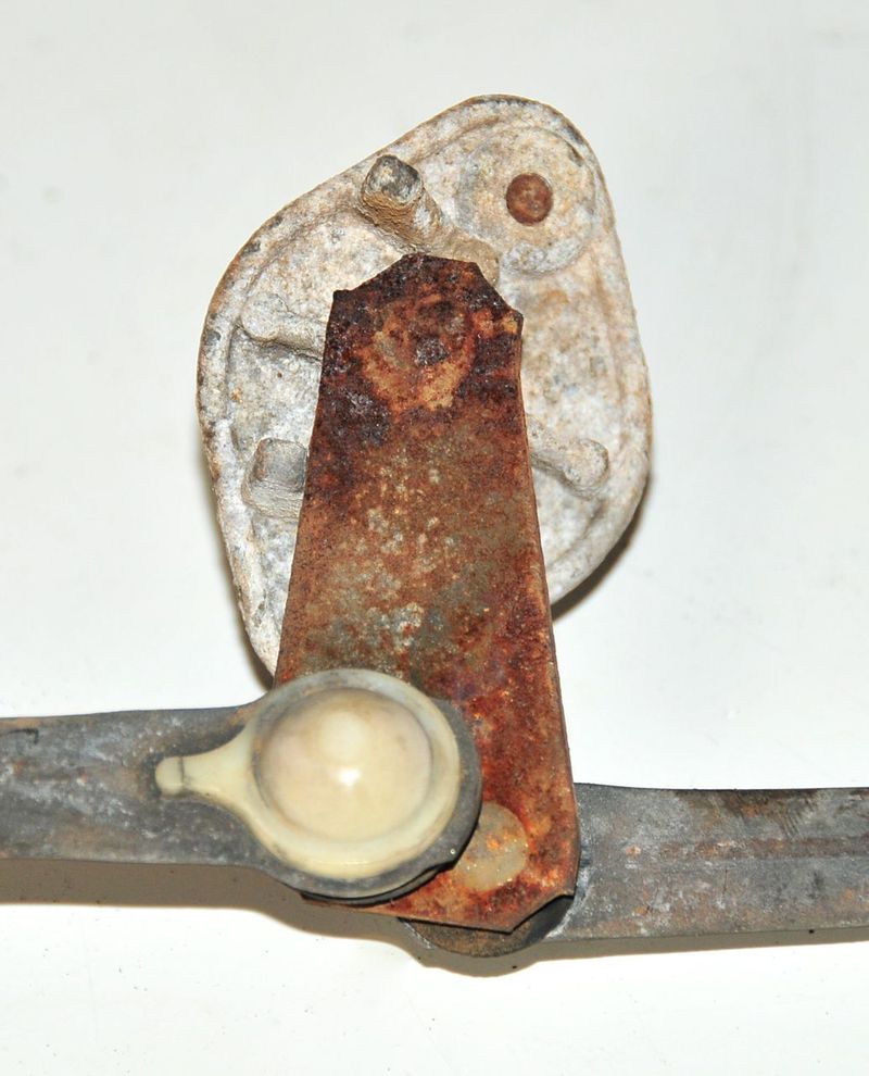

Also, not sure how long the truck sat before/during the swap, but I have also seen the wiper shafts frozen up from sitting and corrosion. A little lubricant can free them up. I have some pictures but it will take me time to find them and upload them. But basically, if you pull the wiper transmission out, you'd want to lube any and all parts that move relative to each other.

ok so i tried cleaning them as best i could and nothing really different to report. im thinking its the module itself at this point. a few clues to go by, it still sends a signal to the motor and the motor seems to be working fine with what its getting, the click for the timer on intermittent clicks once but never again unless i switch it to the second speed and back to the intermittent.
I
imrjbitch
i shouldve took a before pic. it was so bad before that i really thought this would make it better :(

I think you are right about the intermittent module being bad. But I also think you two other problems…. 1) your parking problem, and 2) the weakness problem.

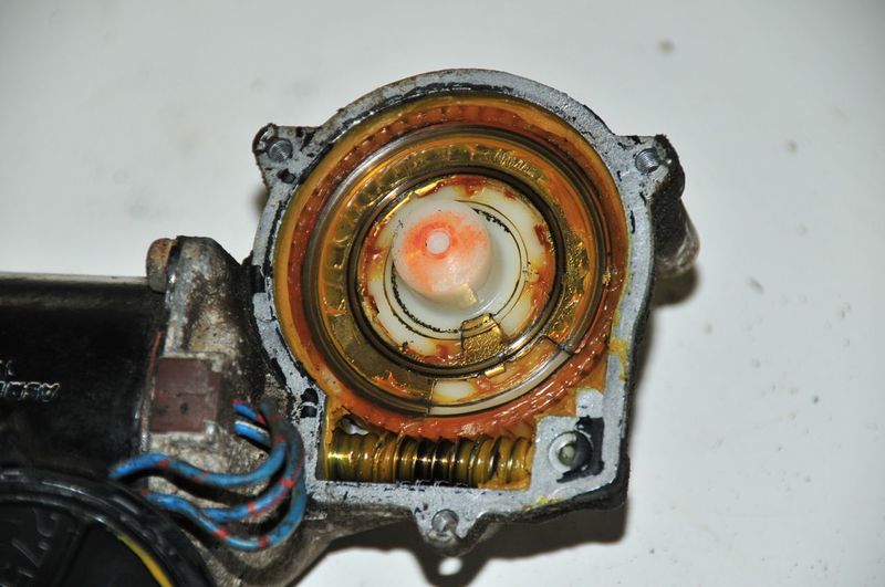

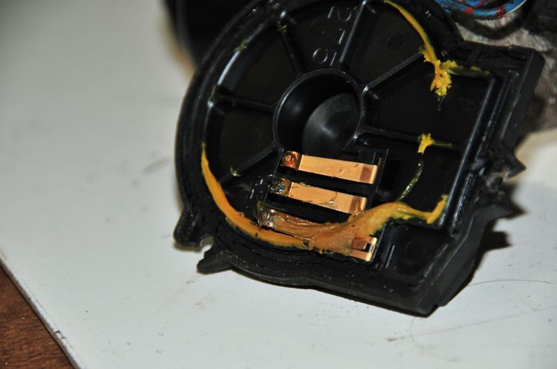

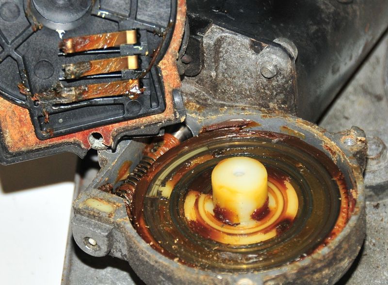

I would try cleaning the points on the motor as well. Here are some pics I dug up. This first one isn't too bad.
