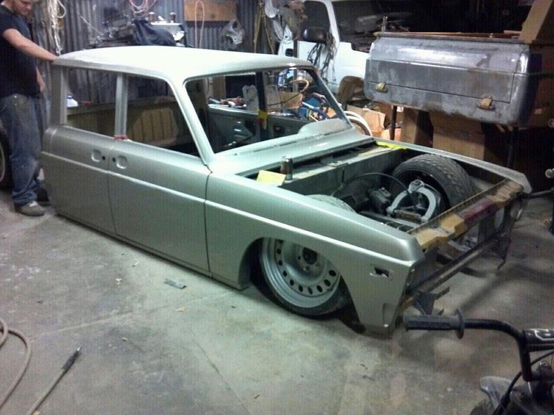

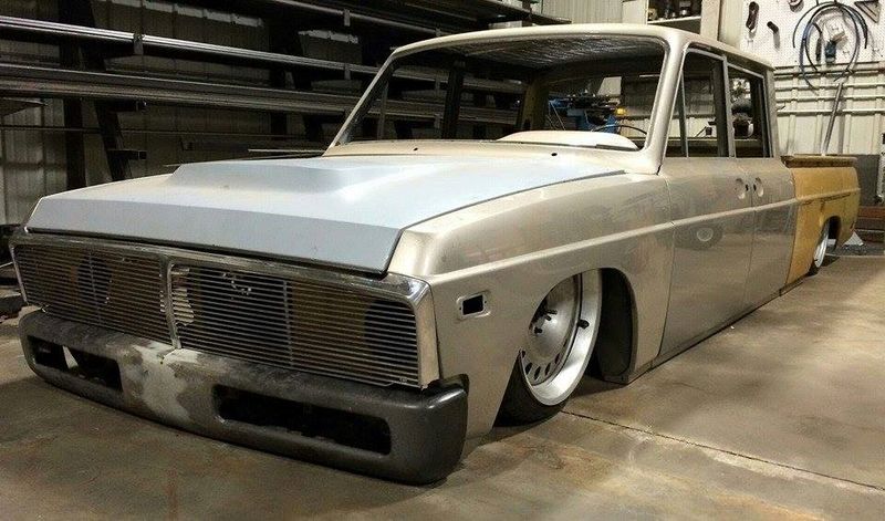

Not much but got past a big hurdle IMO.

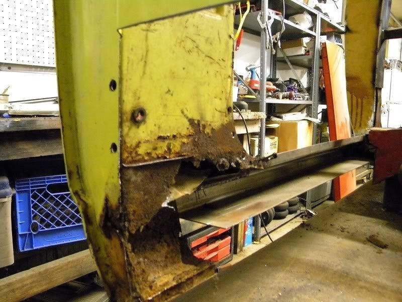

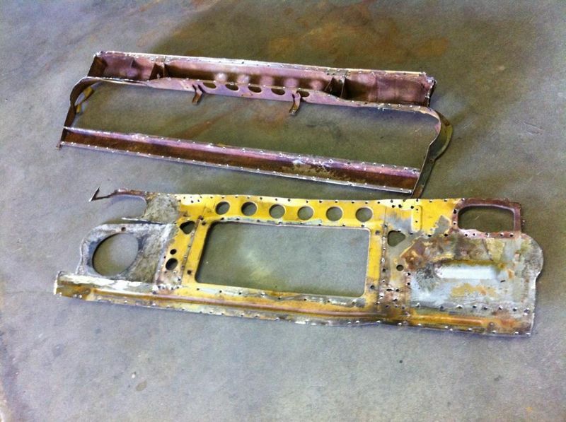

Been working on the B pillar tryin g to get it stout enough to hold both doors and be a structural part of the cab. I ended up making an upper B pillar out of 10ga and skinning the back side with more 10ga.
All welds drilled out and stock pillar removed.

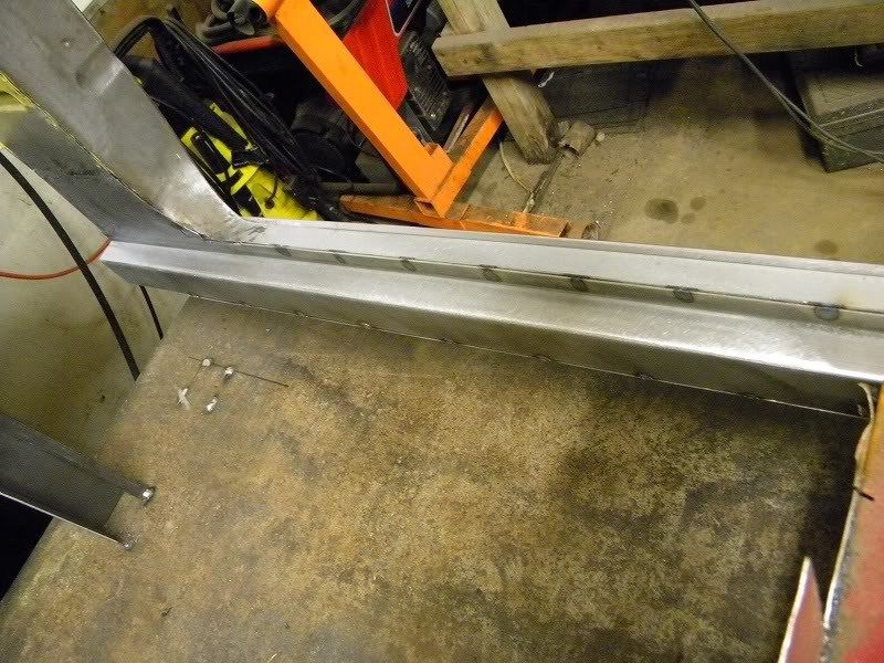

Welded in and bottom blended

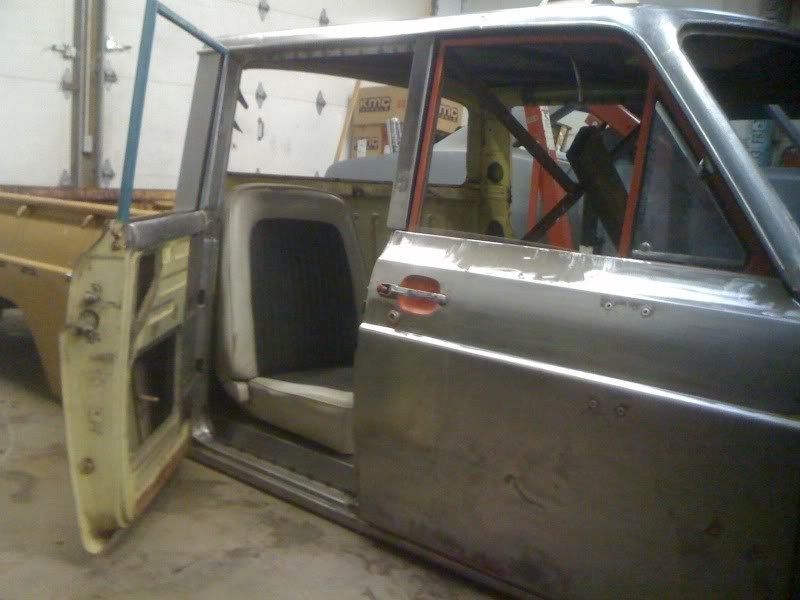

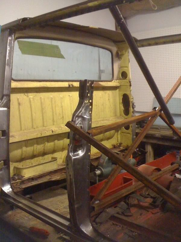

Inside welded up. Even reused the stock seatbelt location

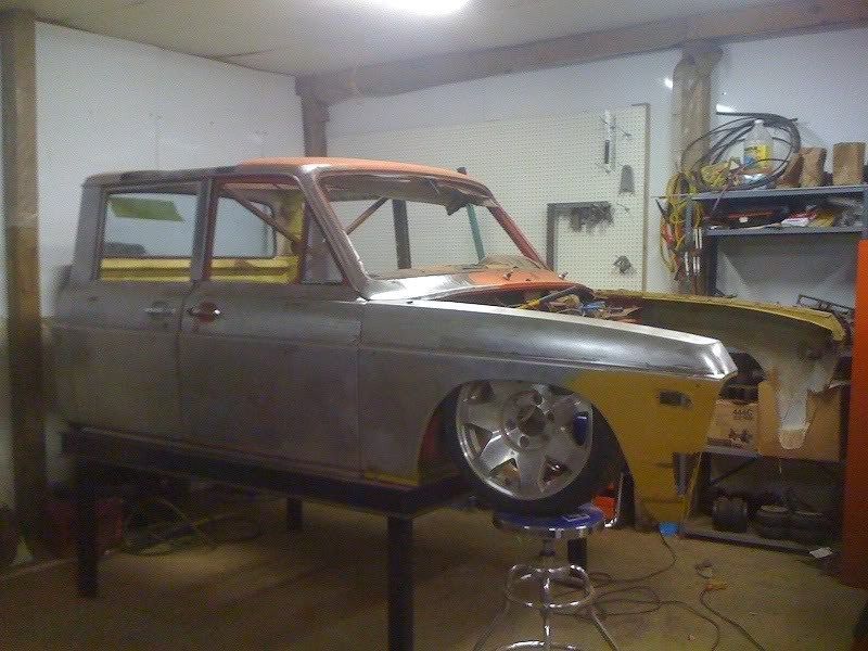

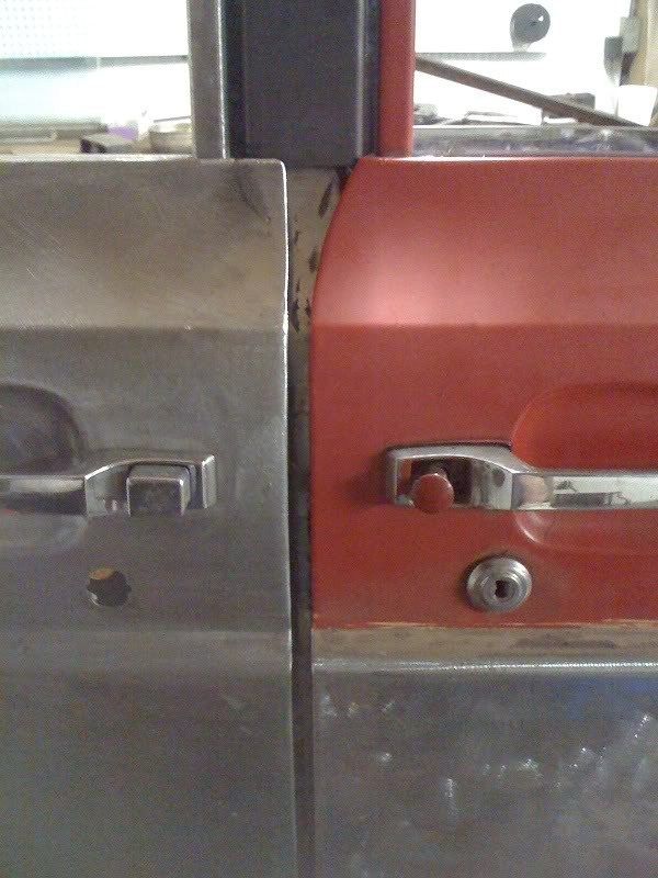

Heres where i began squaring the door corners. The stock doors curve at the rear like the red door, since the front of the back door was the rear of a door i had 2 corners to make.

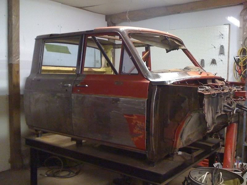

And heres the passenger side 90% done.
All thats left on this side is to set the door gaps and relocate the window crank mechanism on the rear door. Im hoping to have the cab done and sitting on a new chassis by new years. At that point were gonna be hoping to snag some sponsors.
