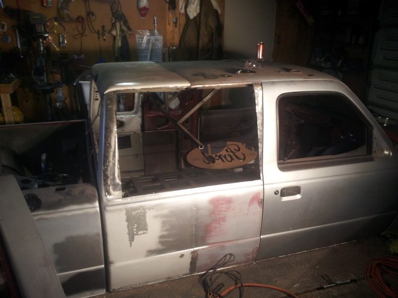

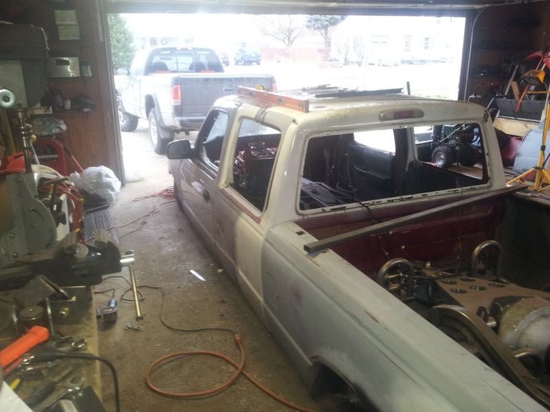

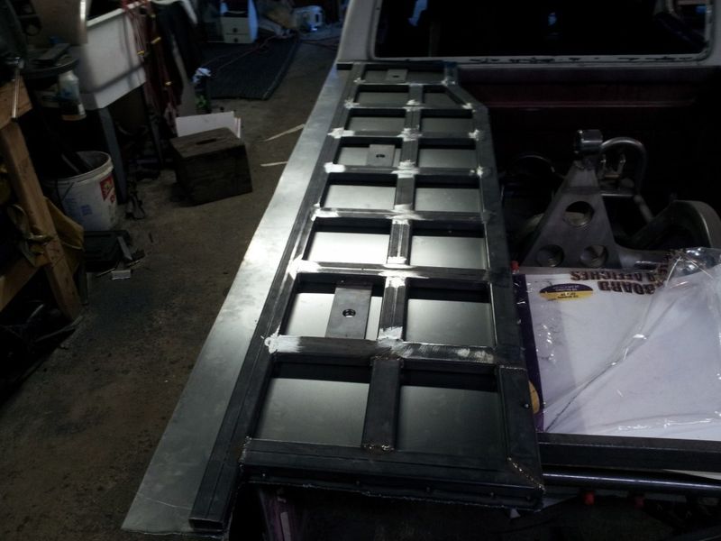

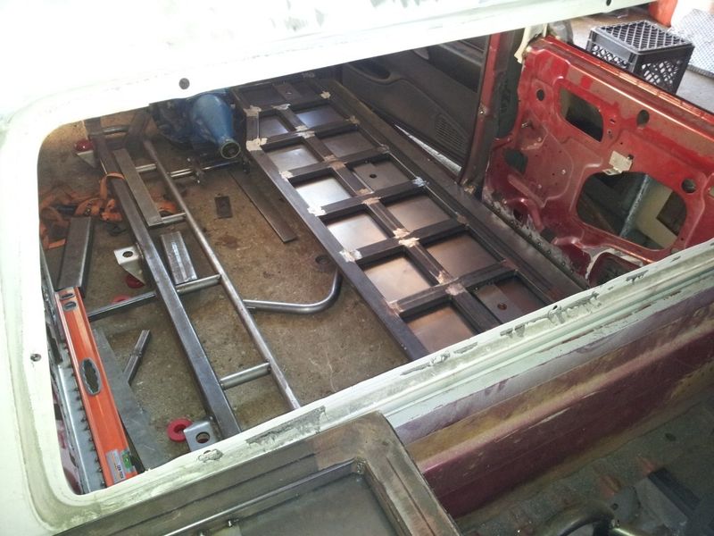

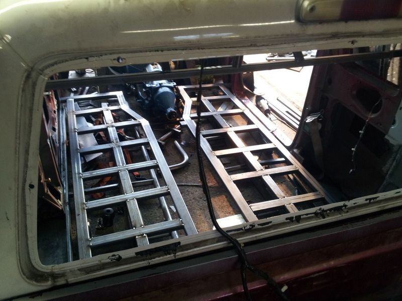

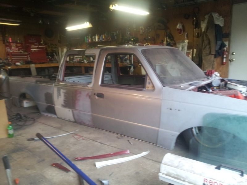

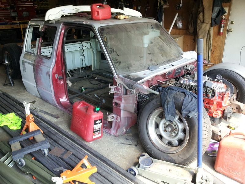

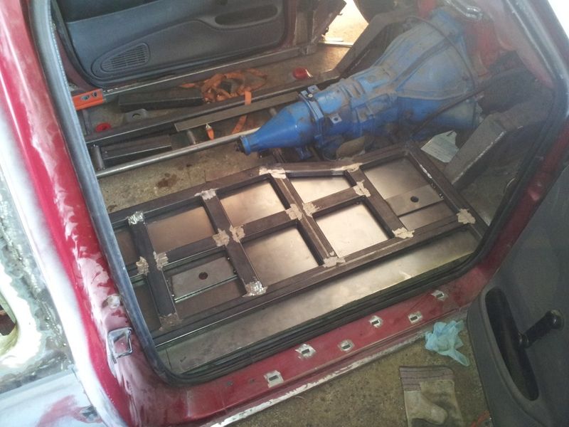

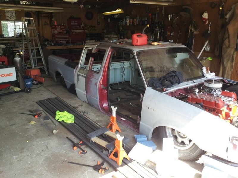

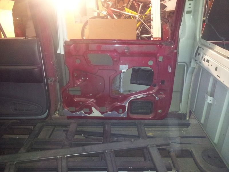

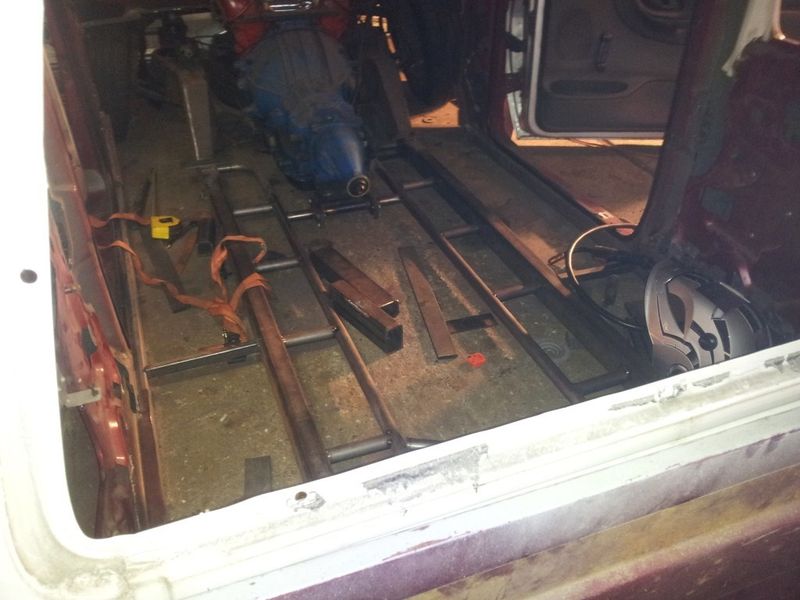

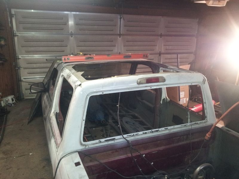

Looks good. Starting to look like a truck again. Are you going to put seats or stereo in the mega cab section? I thinkn it would be cool with jump seats that adults can actually sit in.
Keep up the good work.
strada shop's avatar
strada shop

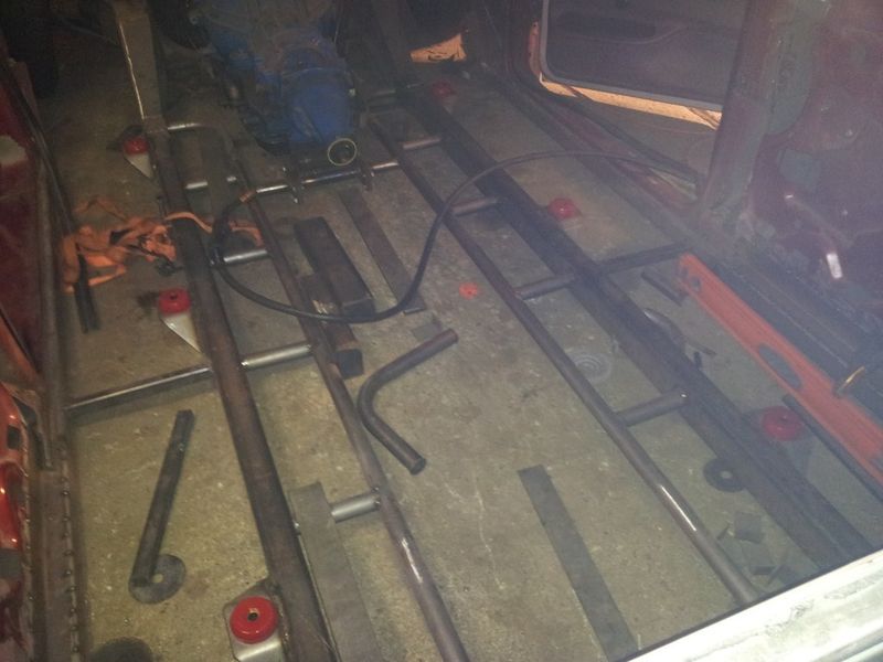

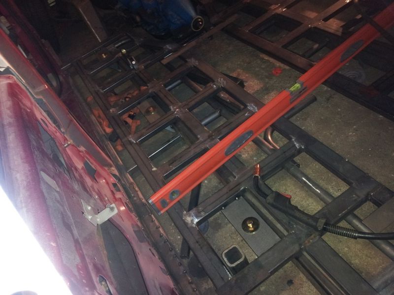

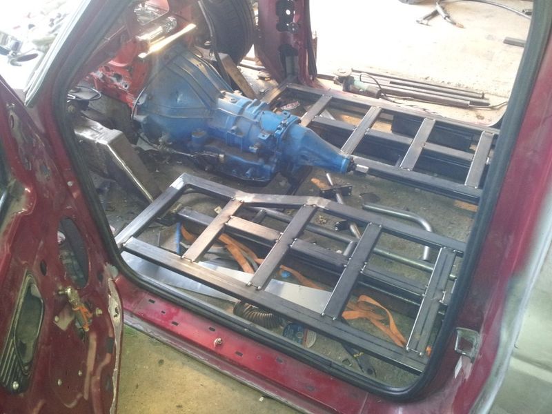

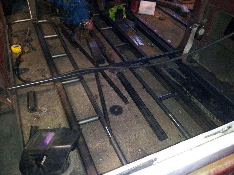

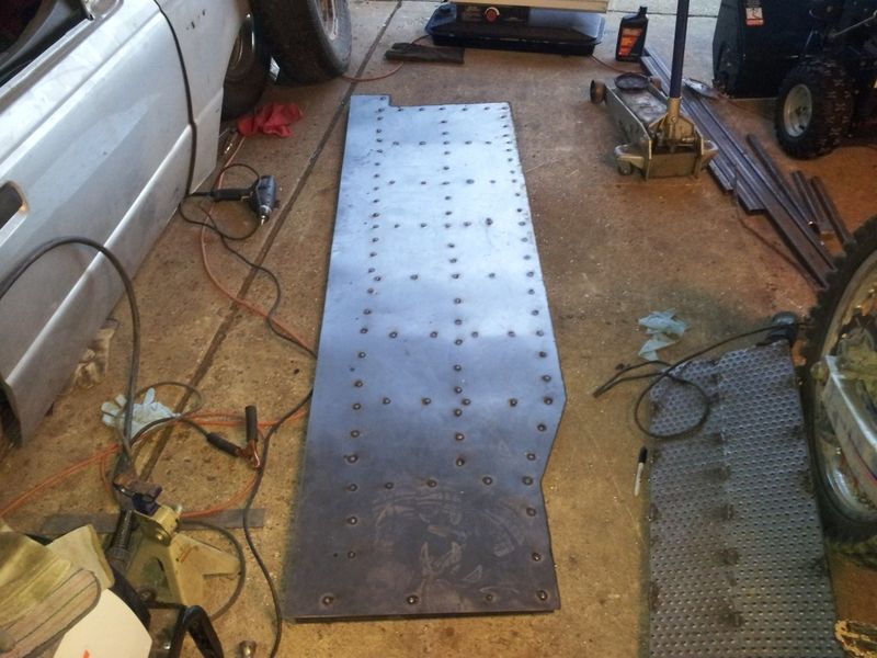

I'll have four bucket seats I'm working on the floor now and building a dash and center console.

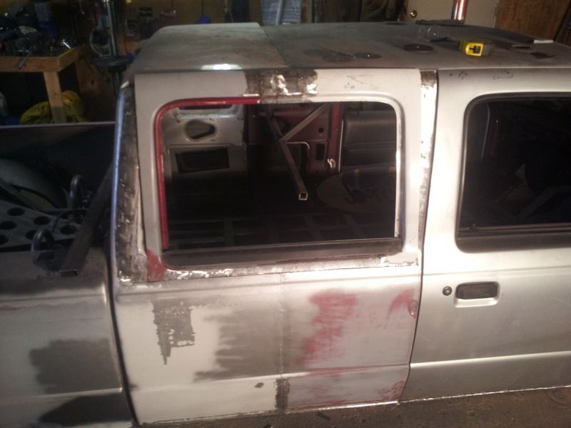

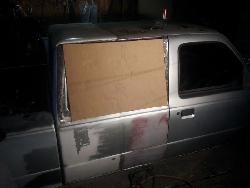

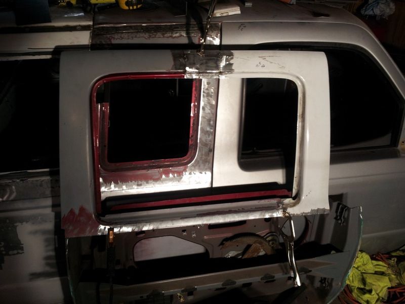

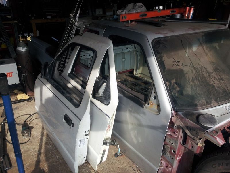

Thanks slappy. What did you use for your window seal on your back windows? I need to find something for mine, I could make.one out of two front door window.seals. Its getting there hoping to get it all finished by next year.
Slappy Mc Nasty's avatar
Slappy Mc Nasty
thats exactly what i did, i used two front door seals to make one for each rear. ran the front portion of one seal for the front of the rear portion, cut it just where the rear just before it started to start going down and same for the rear portion upwards. a small splice is still there but if cut right, it wont be extremely visible.
strada shop
Sweet thats what I'll do then!
