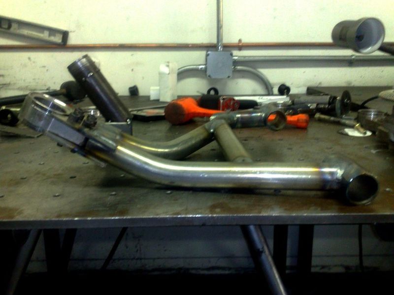

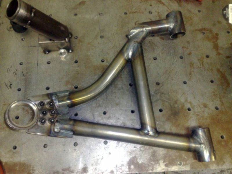

yeah your right on the crossmember  and sorry i was referring to the diffrent arms for all diffrent kinds of trucks and body styles my bad. andyour only wanting uppers if so i do them for 450 bucks a set. thats a 7/8 uniball all bolt in setup. this arm is the lower for your truck that will lay 24s with no cutting at all.
