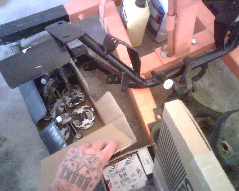

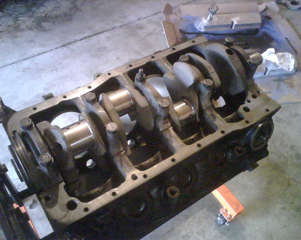

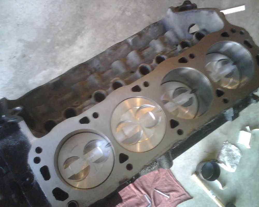

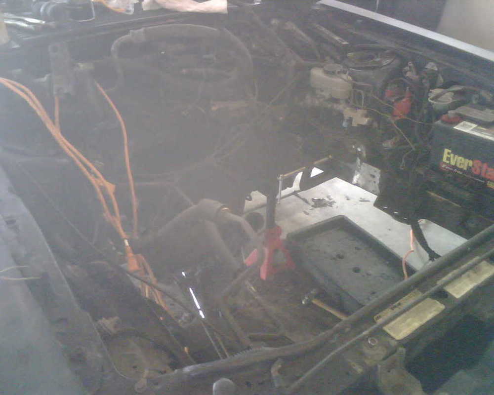

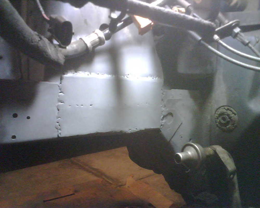

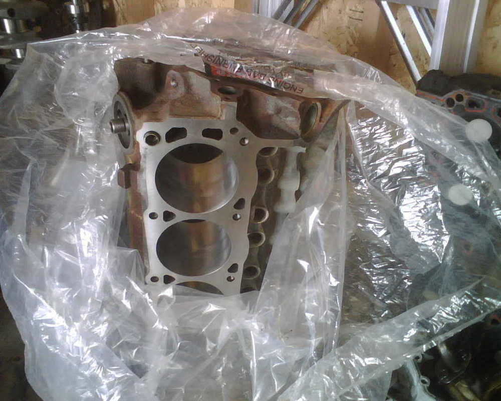

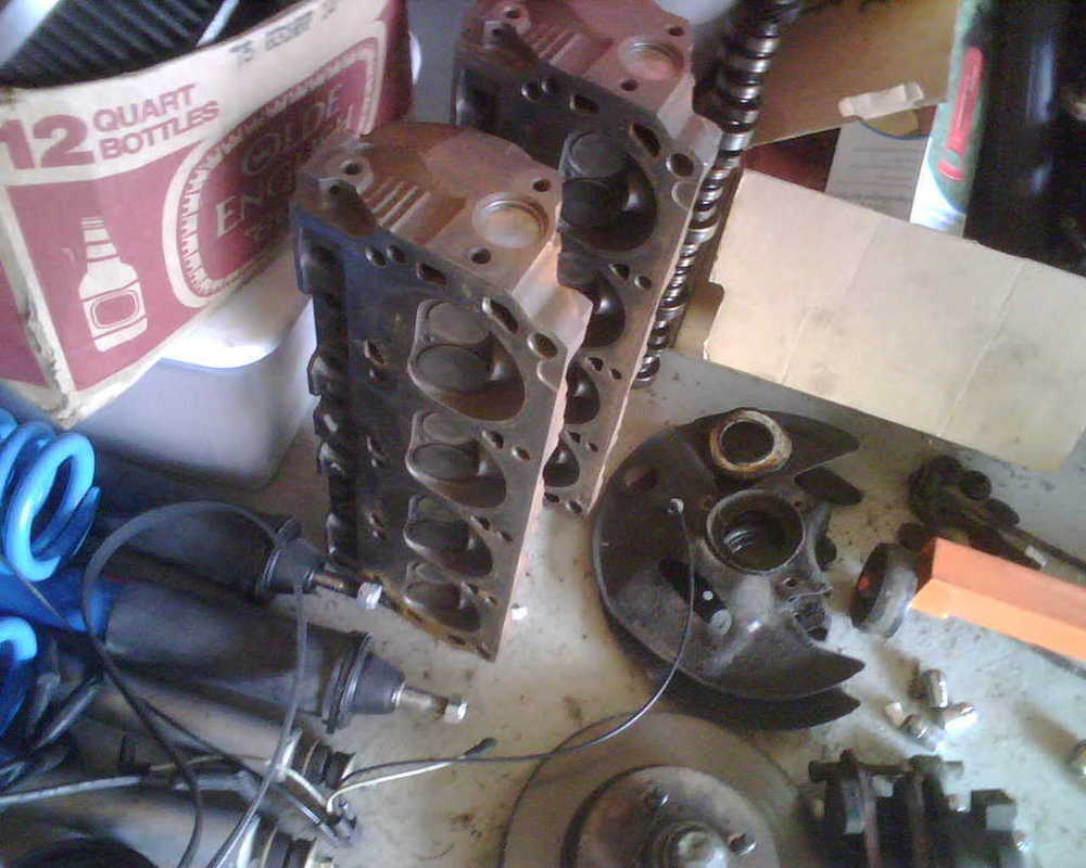

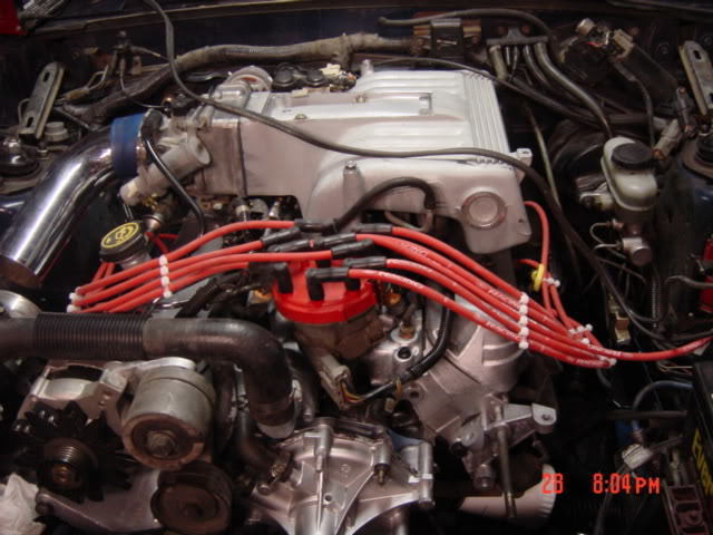

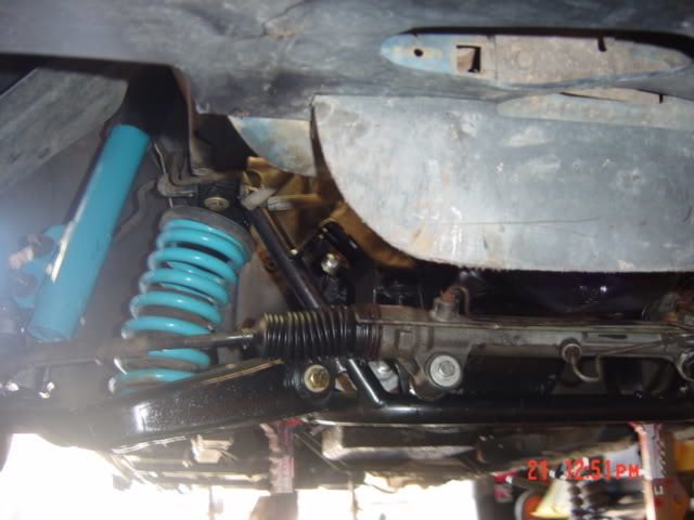

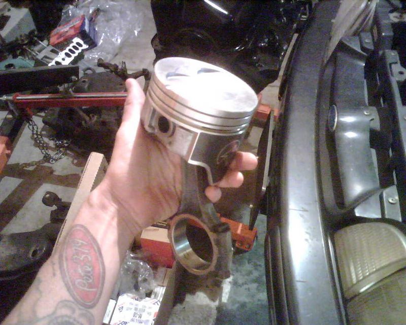

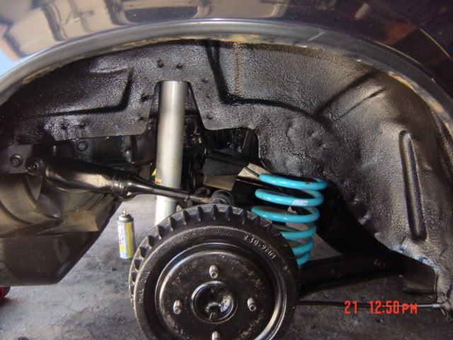

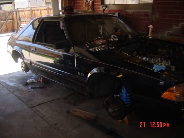

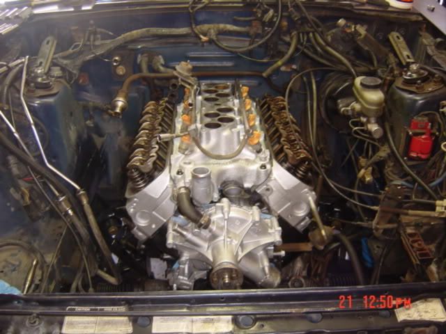

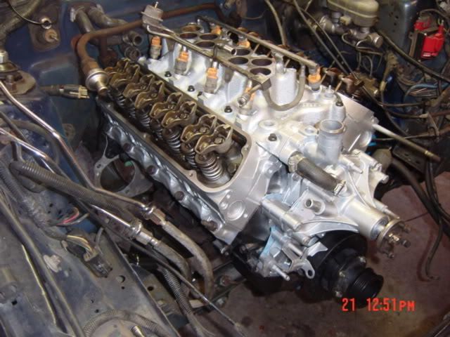

Well my before I can start on my shit I need to finish up my buddys mustang. And after a year of working on it its finally getting to the down hill part of getting this turd running and out of my life......at least till he wants to do more to it.....so heres some skinny on it.... I had the pull the motor rebuild the motor (bored it .20 over) so its a 304...And after pulling the motor I found some major problems with the car. One the stock K member was rusting really bad so I pulled the front end off the car and installed a new Tubular K member, and also found that the unabody part of the front end where the K member bolts too was rusting away so I had to go in and knock out all the old rusted shit and weld in some new shits before installing the new K member. After getting the end of the car back together and the engine back from the mechanist I got the motor together....and reinstalled it back in the car.....then after pulling the rear wheels off the car to check the rear brakes I found that the car had some problems back there.......the pass side brakes were GONE and the pass side axle seal was leaking really bad....So I had to pull the pass side axle and install a new seal...along with new gear oil and with limited slip gear oil additive.....Then went back and installed new brakes with the new fronts......and now im getting to the point where I can finally see the light at the end of the tunnel.....so heres some pics and how she sits today....I will start with what I got up to today......
