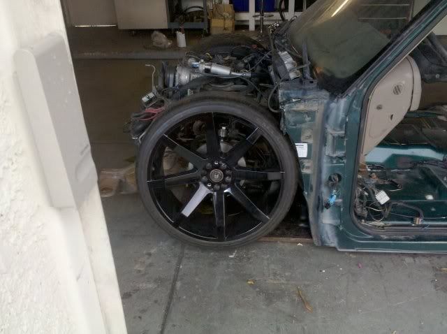

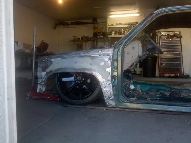

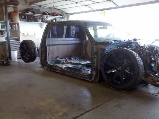

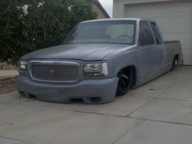

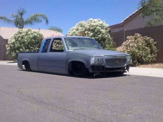

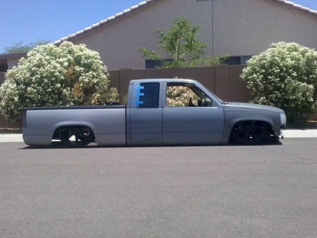

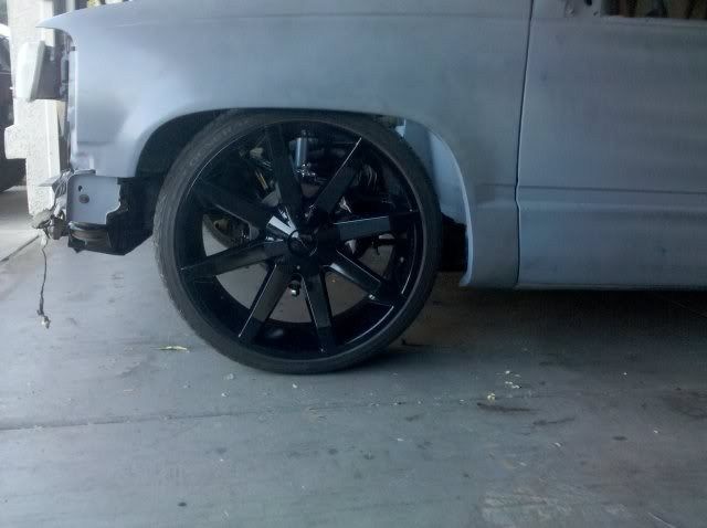

your def gonna have to notch the hood support for those i have 255-30 and it touches the hood right now..  thing is lookin sick though
tre5's avatar
tre5
I didn't touch the hood on the Tahoe I did. It has 255/30.

LOOKS GOOD SELL SOME PAINT BRO HAHAHA
mjavy7's avatar
mjavy7
This truck is looking bad! Keep up the good work. PS the comment about moving the cab back is a good valid sugestion that tire looks out of place right now. I don't know how much wrok that is but, it definatelly looks worth it.
tre5's avatar
tre5

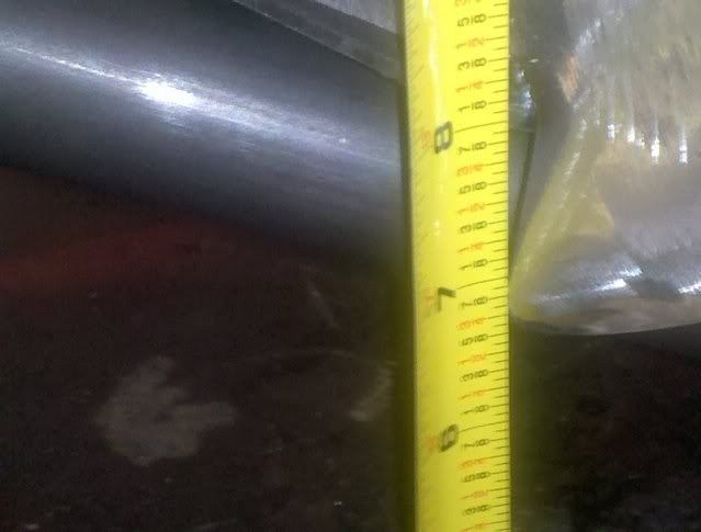

I thought about the 3/4" thing. I am not sure if it would work with the 24s because of the hood slope. It is already going to be really close and pushing the cab back would take away more height.

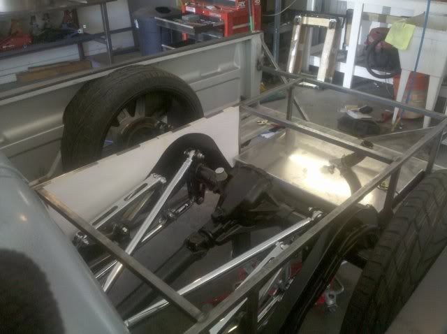

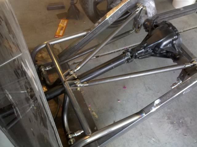

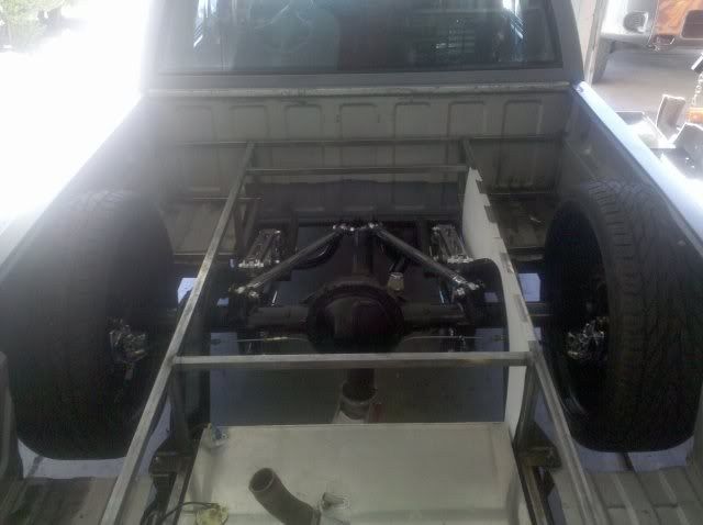

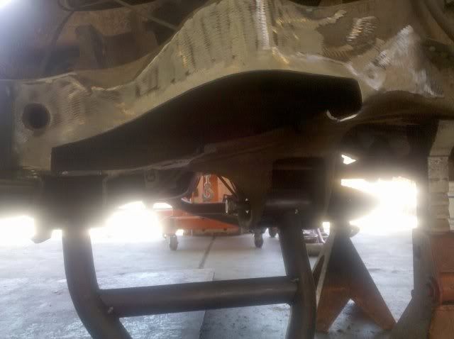

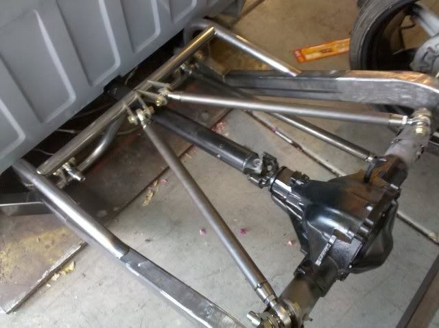

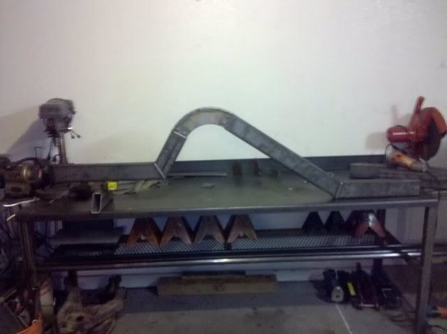

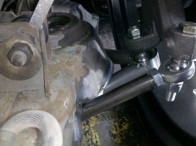

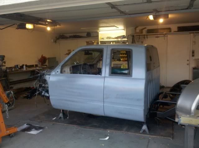

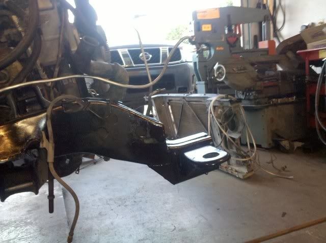

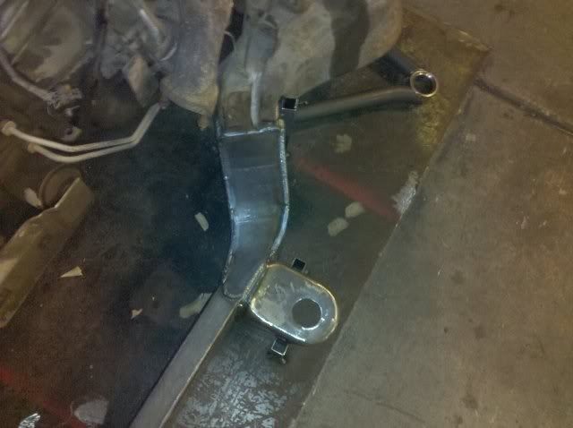

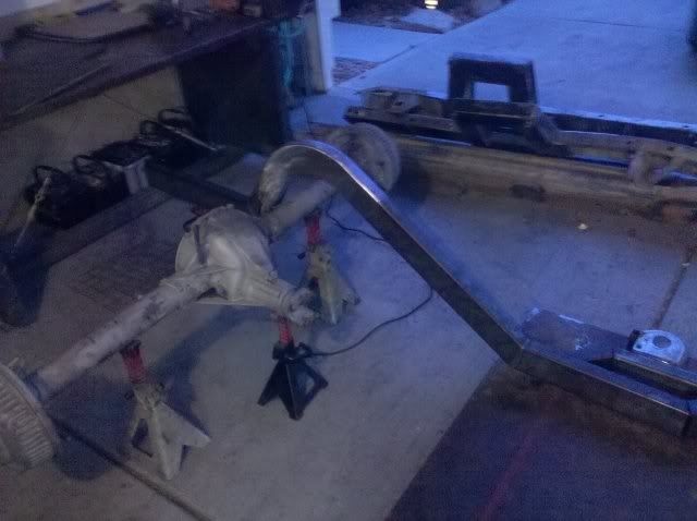

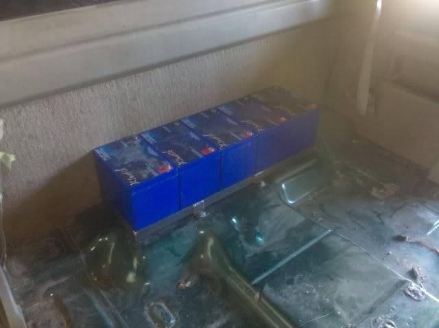

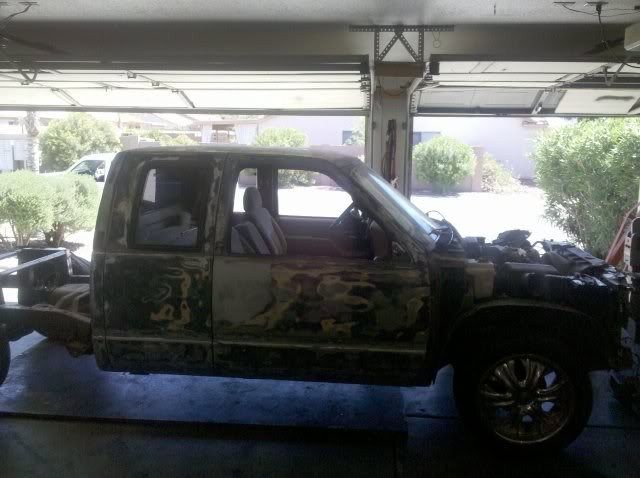

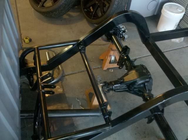

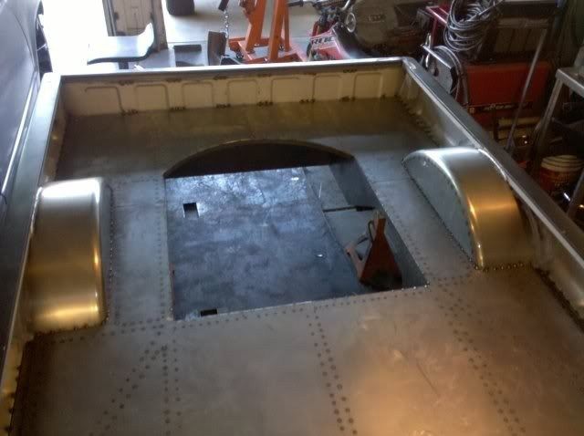

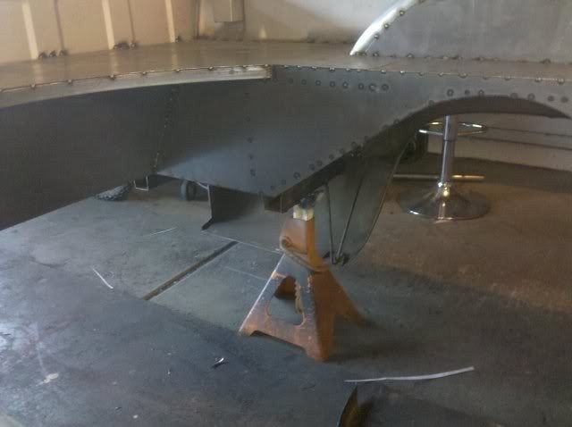

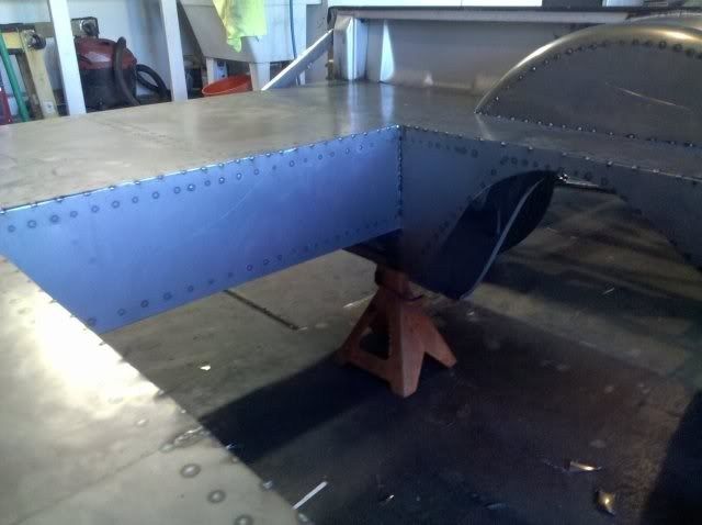

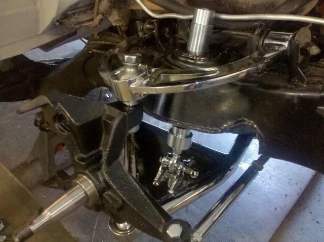

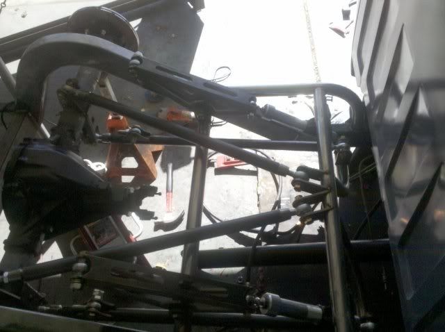

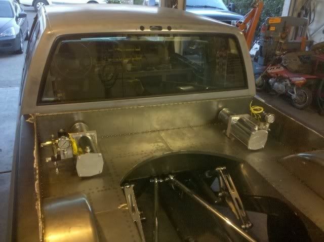

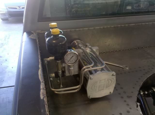

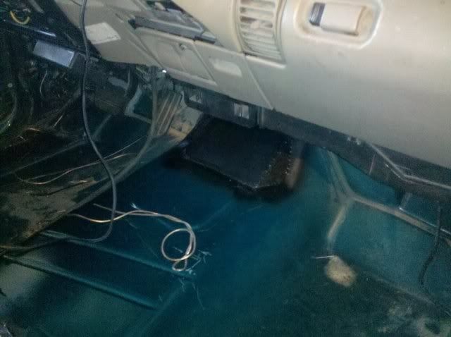

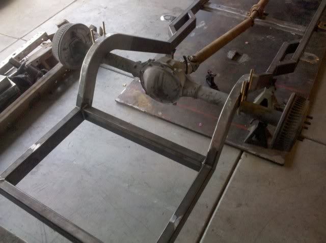

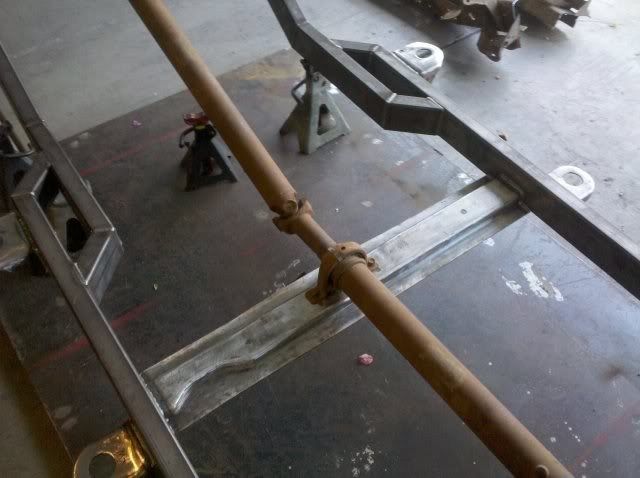

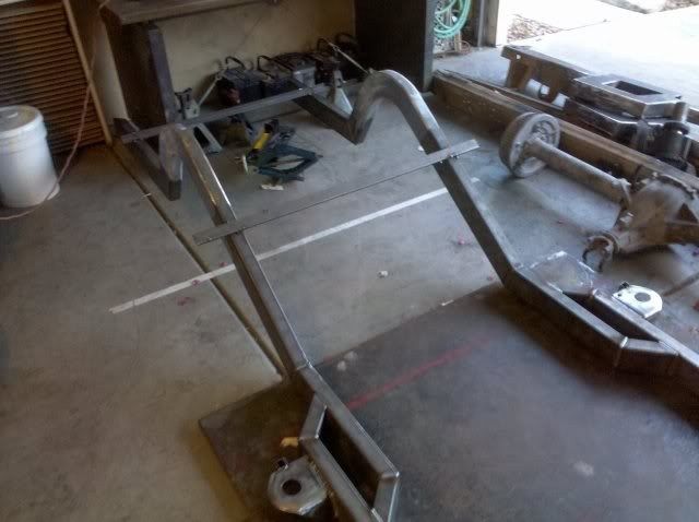

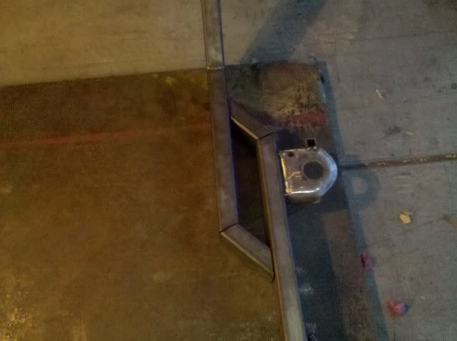

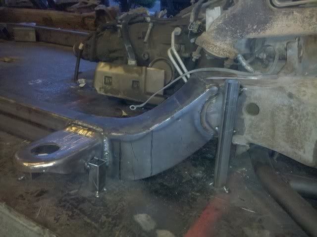

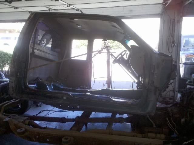

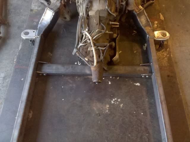

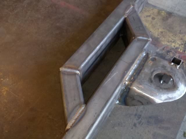

Some pics from today's lousy progress. I am waiting on some heims to get here so I can get the rear suspension finished up. I went back and forth on where to mount the batteries. First idea was inside the cab, then behind the axle with a tall and skinny gas tank. I finally made up my mind... The batteries are going in the extended cab. There will be a custom interior anyway, so the rear seat isn't an issue. Also putting them in the cab keeps a lot of wiring from going along the frame rails. 4 batteries for the hydraulics, 1 for the truck. I also got the front frame horns dropped. I will get them finished up tomorrow. Hopefully those heims come in.

god thats alot of $$ in batteries
JboyDrags's avatar
JboyDrags
looks great so far. cant wait 2 c it done
tre5's avatar
tre5
---------------------------------------------Originally posted by HarryBallsgod thats alot of $$ in batteries---------------------------------------------just another great reason to have them inside the truck. LOL
