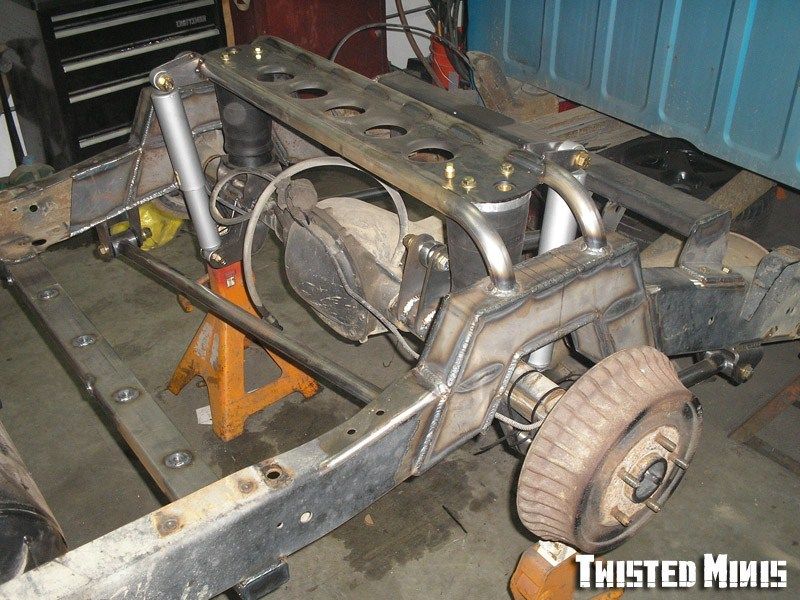

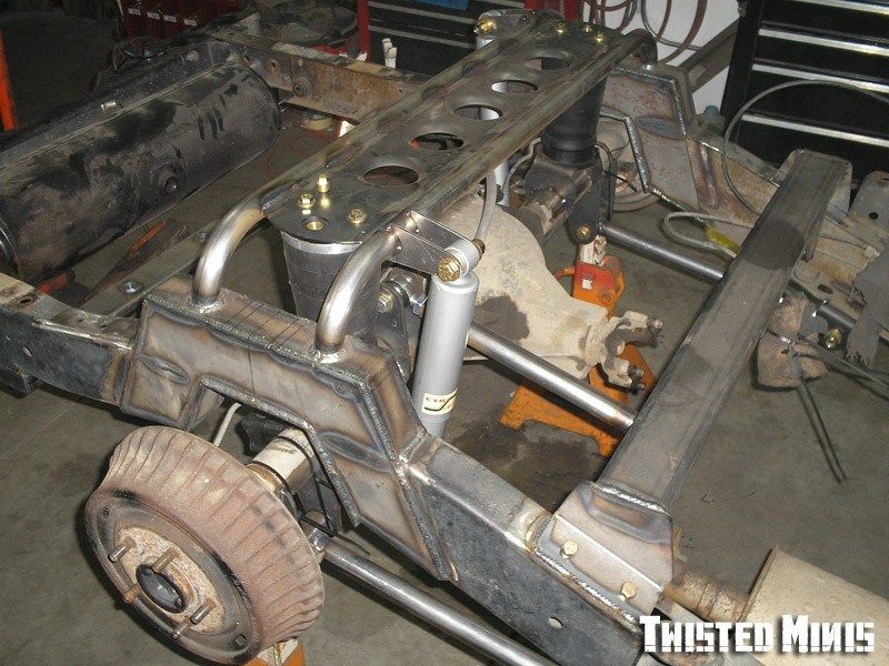

Sick as always! I heard sleeve bags ride great over axle. Is this true? Never actually rode in a truck with sleeves

---------------------------------------------Originally posted by TexmextukinSick as always! I heard sleeve bags ride great over axle. Is this true? Never actually rode in a truck with sleeves--------------------------------------------- I put them on the Datsun, and that truck rode awesome.

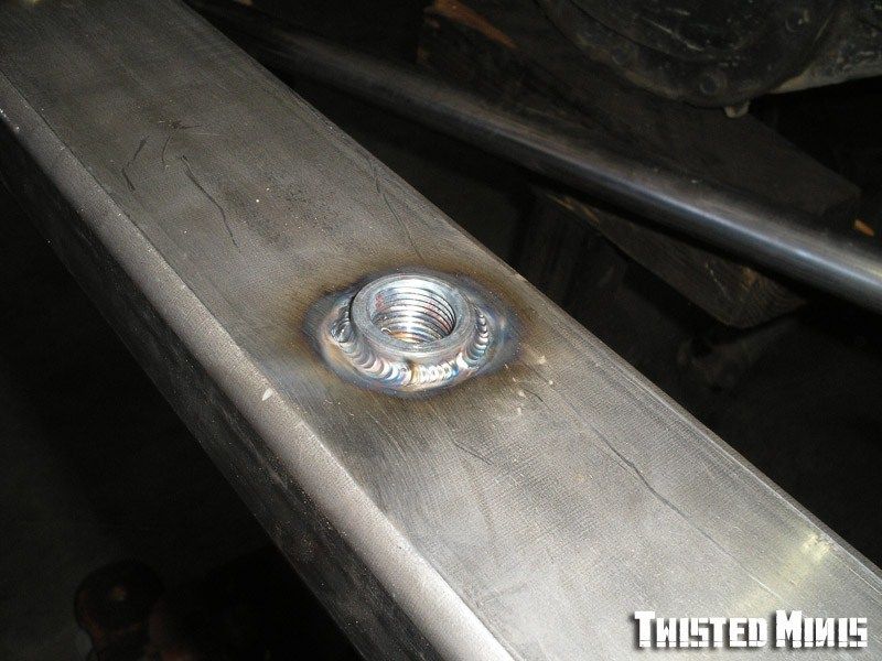

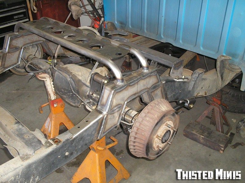

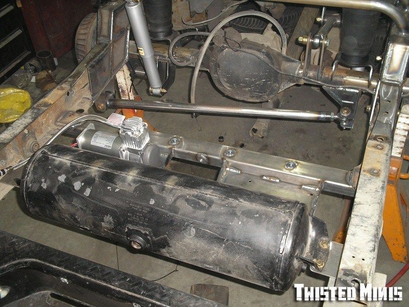

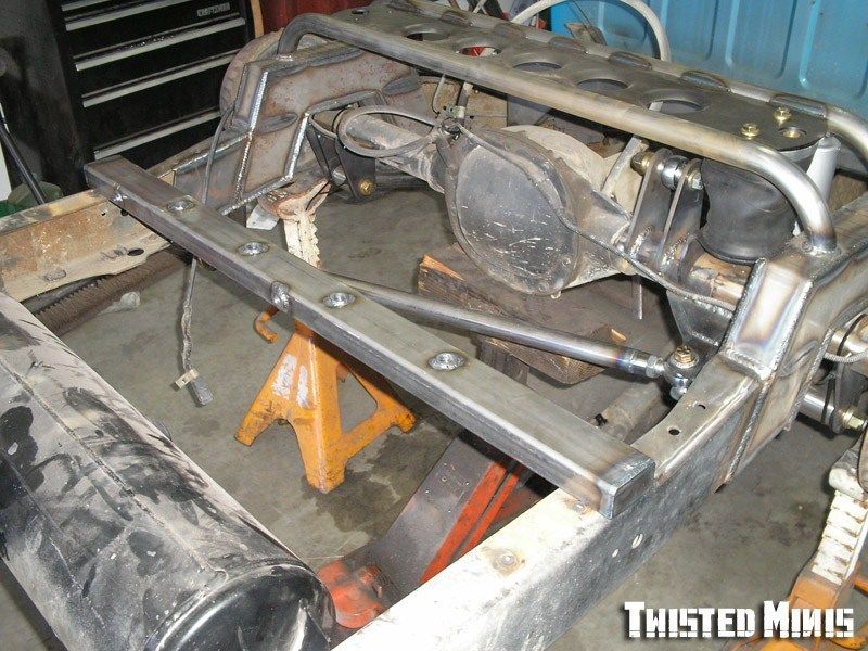

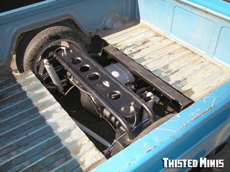

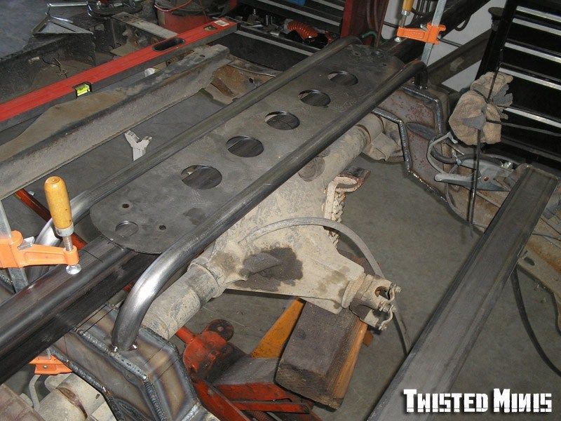

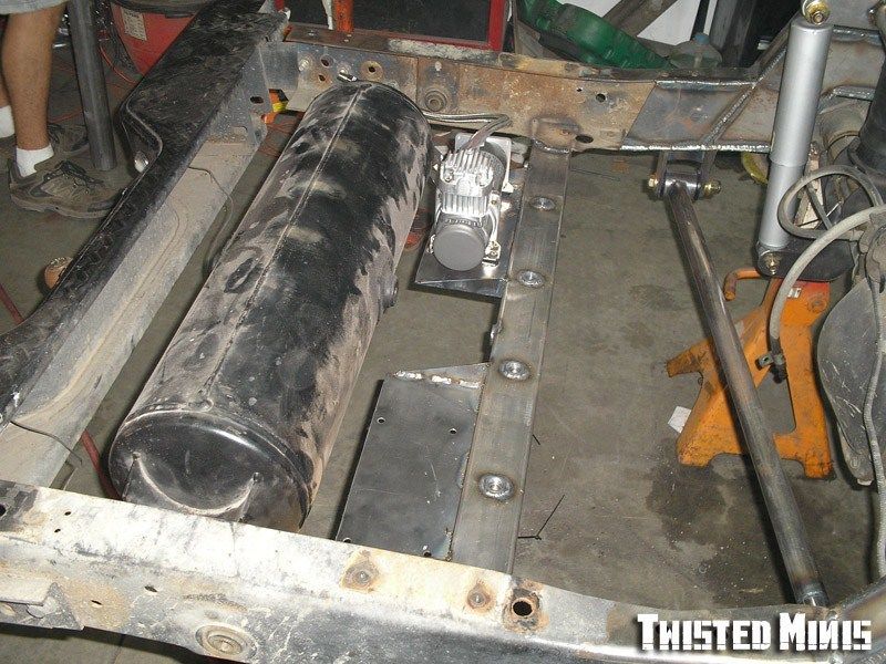

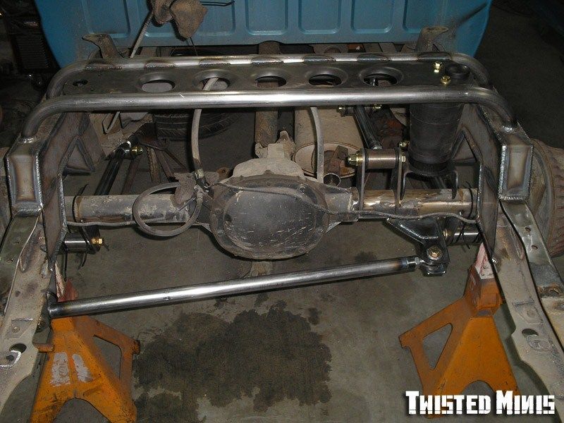

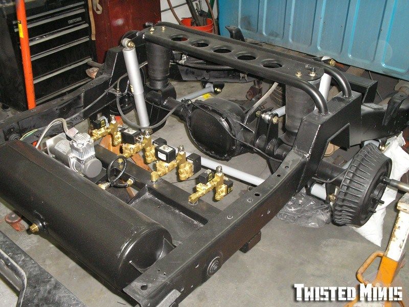

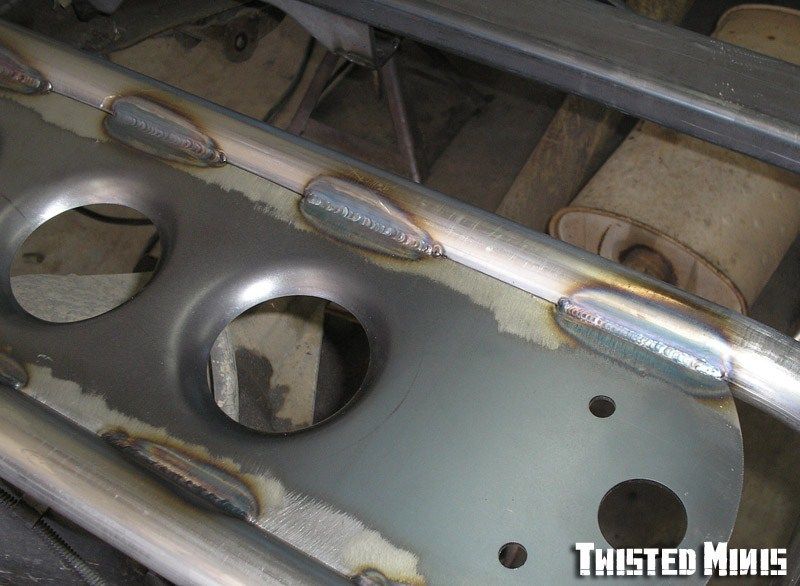

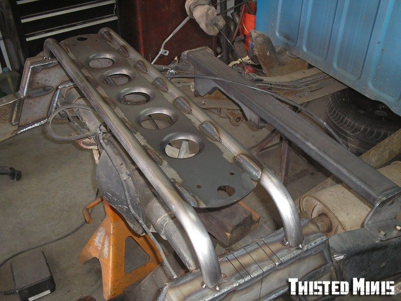

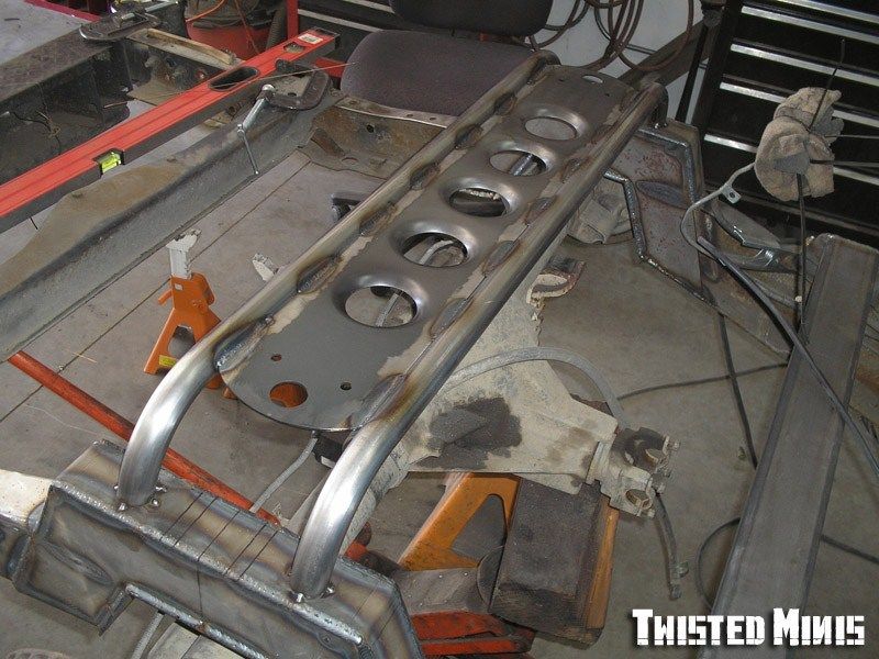

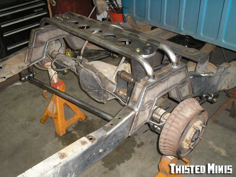

Today I built what will be both a crossmember, and an air manifold. It's sitting on top of the frame, which is not where it will end up. I need to pressure test it before I weld it to the frame. The goal is to keep the tank, compressors and valves all under the stock bed floor. I am using a "manifold" to mount the valves because the tank only has 4 ports.
stewranger's avatar
stewranger
Cool ideal with the manifold, rest of the build looks great as always. I like the dimpled crossmember, did Joel cut the plate for you ?

---------------------------------------------Originally posted by TwistedMinis I am using a "manifold" to mount the valves because the tank only has 4 ports.---------------------------------------------i know you are a damn professional and love to show your talents but could you just weld another bung into the tank rather than welding up alot of metal to accomodate?i only wish i could have got into the scene when i was younger like you are, truly an asset to the entire genre

It is true sleeve bags ride awsome over the axel.  I would never bag another truck over the axel without sleeves.  My toyota has them in the back with a nice set of shocks and it rides better than a cadillac.

Edited: 9/5/2009 2:01:07 AM by TwistedMinis
---------------------------------------------Originally posted by Slappy Mc Nasty---------------------------------------------Originally posted by TwistedMinis I am using a "manifold" to mount the valves because the tank only has 4 ports.---------------------------------------------i know you are a damn professional and love to show your talents but could you just weld another bung into the tank rather than welding up alot of metal to accomodate?i only wish i could have got into the scene when i was younger like you are, truly an asset to the entire genre--------------------------------------------- It's the same amount of work and welding both ways.
