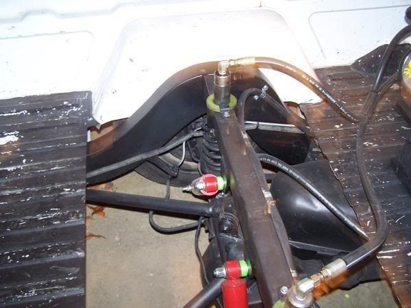

Ya, Jake and Bills trucks rode great. I make the same bushings Craig is talking about out of Nylon too. They made a huge difference in the squeaking and rubbing of the cylinders. I would deffinitly put some in if your cylinders are passing though steel!

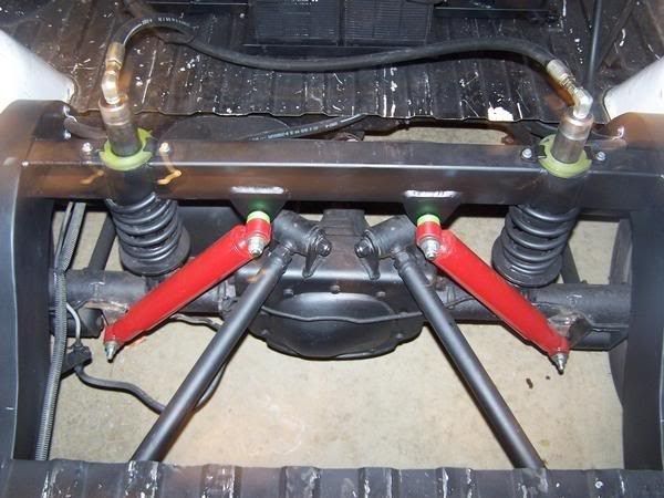

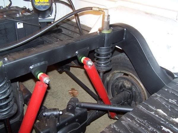

all my works done by eyepoppincustoms. the green insert that the cylinder rides in is the oil inpregnated nylon super smooth ride and no squeaking! or accumulators cuz thatd be cheating ;)
