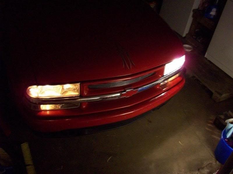

help... one headlight is dimmer then the other

it would not get the power to run the hid's. well i just went and recheched the fuses under the hood and on the inside, and all are good. heres a pic

get new lights, sometimes when i sell the ultra white lights one is dimmer than the other. and i just give the customers new ones and no more problems
project94
maybe try checking the relay?

you figure it out? mine does the same thing I thought it may be a ground so I added new ones and it still does it.

i would check the wiring, how do your turn signals and running lights look. Sometime if the other lights on the same circuit have a ground problem it can feed through other lights. If you have a Haynes manual, check to see what is all linked together.

take a current(amperage) reading on each headlight harness. if the readings are not the same on each headlight just replace the headlight harness...if you checked all fuses, checked all relays, checked all grounds and swaped bulbs from one side to the other and the right side stayed dim, then it sounds like you have a wire that is "pinpointing" meaning the wire is corroding from inside its insulation. with out the right test equipment you may never find where this is hapening in the 2-4feet of wire...just get a new harness from the junk yard, or the do it hard way... cut the old harness open find the wire for that headlight, cut it out, solder in a new wire of the same gauge, heatshrink the connection then re-tape the entire harness. just my opinion on a fix
A pinpointed wire could happen if you were running a cheap set of superwhite bulbs that pulled too much current for the factory wire to handle. i know that is what the fuse is SUPPOSED to protect but you know... Custom happens
