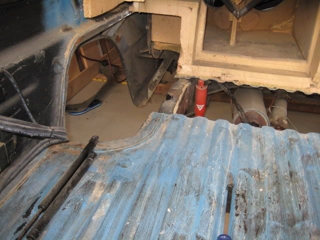

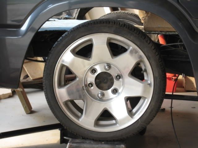

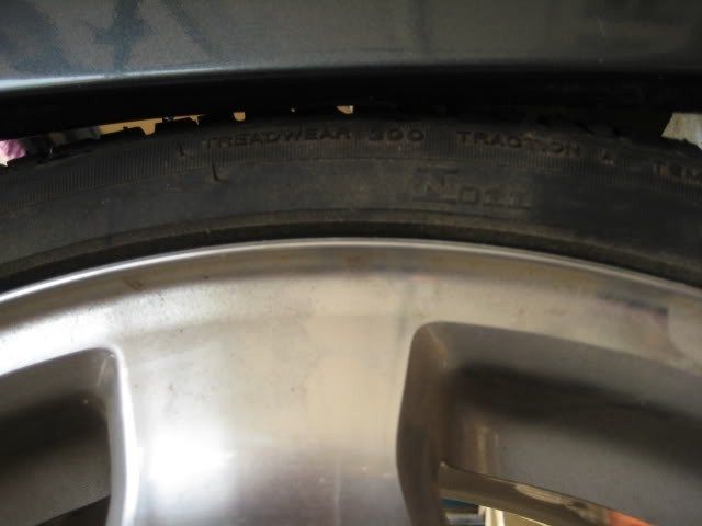

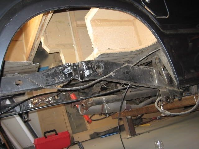

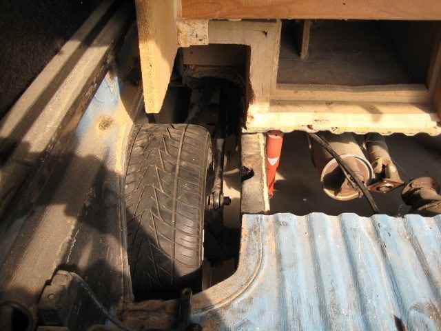

I was coming here with a similar dilemma. What I am doing is replacing some stock B2600 wheels with some 17" Escalades. I'm In process of building the Notch to lay Frame. I have already conceded on the need to move My Four Link from the outside of the Frame to the inside forcing me to relocate of replace the gas tank. Tried to day to see if the wheels would clear the fenders. No I'm sure many of you know. What semi luck I do have is 2 years ago I bought parts B2600 for the front fenders and drilled the spot welds for the rear fenders and kept them as well. Now do I try to find a new B2600 Bed, weld these fenders to mine, or Narrow the rear? What forced me to cut up the other B2600 bed was I already had a LARGE 8 10" woofer Box Installed (See Profile) and just did not want to cut it out. Still don't but have cut into it a bit.
The bit of a arch you see here was to get the ride to sit level with the 15" Stock B2600 wheels at 3" off the ground.

Some more photo I up-loaded
